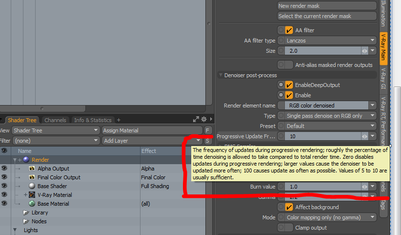

Another thing I'm wondering when working with V-Ray RT is the fact that when using the denoiser, it's not only calculating the denoiser at the end of the render, but every couple of noise-level steps which leads to unnecessary additional rendertimes, especially when rendering with higher-resolution where the denoising process can take up to several minutes. Isn't there a possibility to manually deactivate these additional denoising steps and only denoise the render after reaching the defined noise threshold, rendertime per frame or sample-per-ray?
