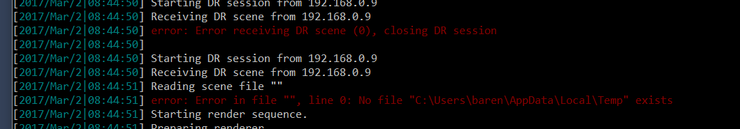

        1. Bucket render issue:
        I get the following error on the slave that render black. This can be with any setting for GI (BF or IM)
        2. the RT issue only happens when I use Irradiance Map as Primarry. Whenever I use BF it always works.
        There are no errors on the slaves or master (event Log)
          It seems to solve the bucket render issue if I run the slave as administrator. (I never did this with any previous version of vray, so something is weird maybe with the installation?)

                Yesterday running my slaves as administrator resolved this issue. Today with the latest nightly I cannot DR to work.
                This is the error on the slaves console:

                  This particular DR issue, where black buckets are rendered on the servers in production mode, should be fixed in the nightly build from 2017.03.11 .
                  Greetings,
                  Vladimir Nedev
                    Thanks Vladimir.
                    I did install it on the 11th and to date I can confirm it is working. I haven't had this bug in the last few days.
