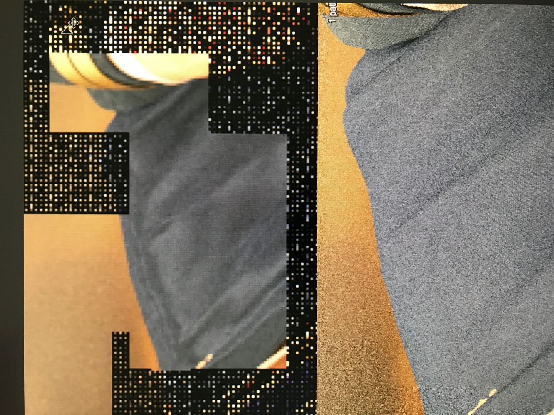

    I noticed a major difference in bump mapping in production and rt. The lower and correct image is from rt -see link-
    The object is a vray proxy and the material is a alsurface. All Bump settings from every layer inside the shader are set to 3mm. Its from the most recent nightly, I didn?t check it on a previous versions yet. I tried bump shadow and lower bump settings as well with no results

    Just tried the normal Vray Material, it has the same issue

        Is that GPU vs CPU render (potentially with bitmap with high-frequency details) ?

          its CPU and yeah its a cloth bump with high frequency. I did load the problem objects into a separate scene where it strangely didn?t display the difference between production and RT. But for some reason I switched the Anti Aliasing Button on and the bump effect looked better :0) I attached a reduced version of the scene.

            High-frequency textures used for bump are known to be rendered differently in V-Ray GPU. Keep in mind that V-Ray GPU is a separate engine, and although it shares the same UI and often renders close to V-Ray CPU, our goal is not to make them matching exactly and they will never render 1:1 (but often will render close). Such differences can be expected and are rather normal.
            In this case however, if you use a lower resolution version of the textures for the bump mapping, the result should be closer.

              oh my bad! With RT I mean not GPU! I mean actually the Interactive Rendering and the final Production Rendering
              So all CPU, sorry for the confusion! So maybe I try MipMapping on that one?
