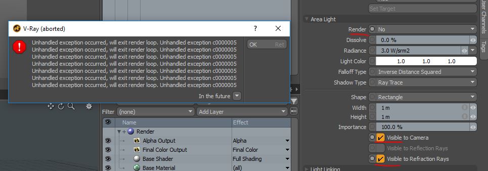

    1. Add a sphere
    2. Add an area light and enable visible to camera + visible to refraction rays
    3. Set area light > v-ray light > light mesh = sphere
    4. Start RT
    5. Set area light > render = No
    RESULT: Unhandled exception

    Hey Funk,
    Appreciate your posts. Well done, I think we have this issue on the list: https://forums.chaosgroup.com/showth...-in-this-scene.
    Cheers,
    Boyan Nalchadjiiski | QA Engineer @ Chaos |
    E-mail: boyan.nalchadjiiski@chaos.com
      Ah yes you're right. It could be the same bug.
