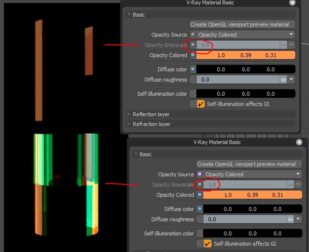

    I'm just testing the new "opacity colored" channel in the nightlies and discovered that "opacity grayscale" is still affecting it, even though it's disabled. This can be seen clearly in refractive materials.
    Disabled channels should not affect anything else

    Hi Funk,
    Thank you for the post. I will record the issue to the system and keep you informed.
