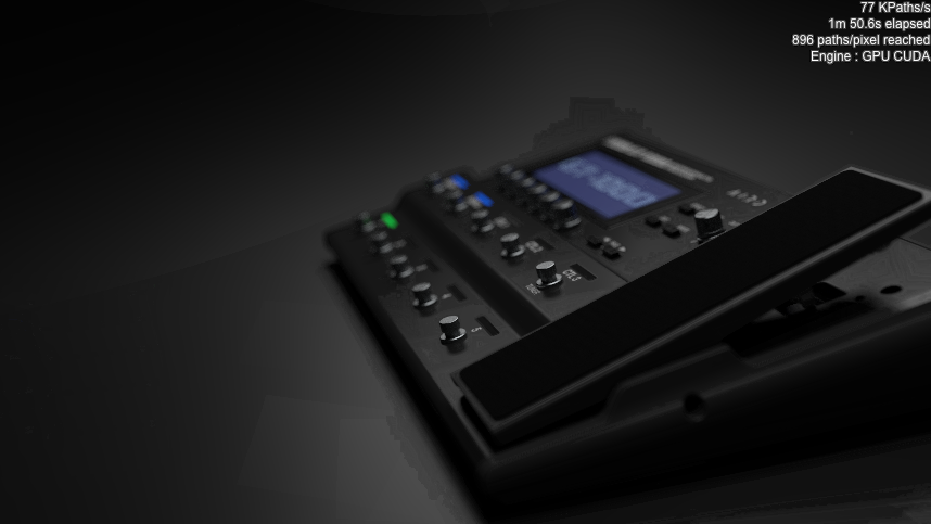

                          DoF works now, but the render looks odd.
                          I also don't think the scene is actually reaching the GPU? My CPU activity is basically the same for either attachment.
                          Cuda options have also disappeared on the preference window.
                          Best,
                          Nick
                          • #14
                            Sorry, I completely broke the macOS builds for the GPU renderer, it's indeed not rendering on GPU at all.
                            I will run the builds again and let you know when there is a working version you can test.
                            Should be in about an hour hopefully.
