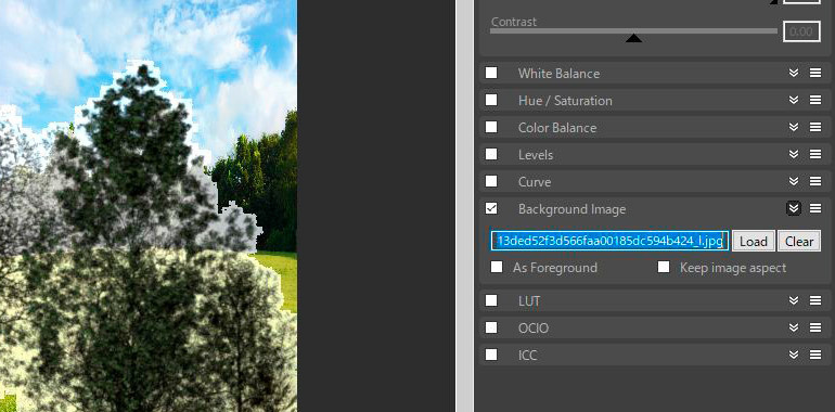

    When setting the background with VFB, RPC Tree does not transmit correctly.
    Is there a way to solve this with V-Ray Revit?

    Hi Yuji,
    Which version are you using?

      V-Ray 3.70.05.
      Has V-Ray Next for Revit Beta solved the problem?

        Yes, in the beta, there is another workflow which will allow you to achieve the same result but without the artifacts around the RPC tree.

          OKey.
          I will tell my customer who reported this problem that the solution will be implemented in V-RayNext.

            It is already implemented in the beta. They can try it out.
