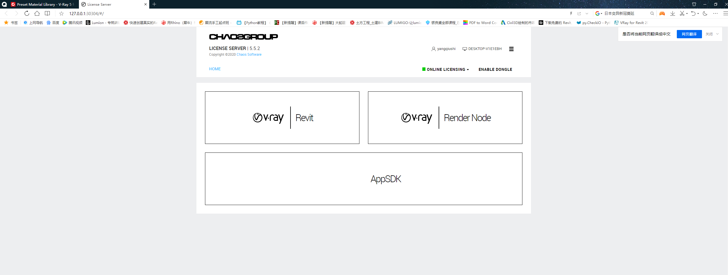

    I installed V-Ray for Revit and successfully downloaded the material library for the first time. However, when I changed the location of the material library, I opened the material library and prompted me to have no permission. Is it where I set it wrong?
    I confirm that I have a V-Ray License Server and can render normally.
