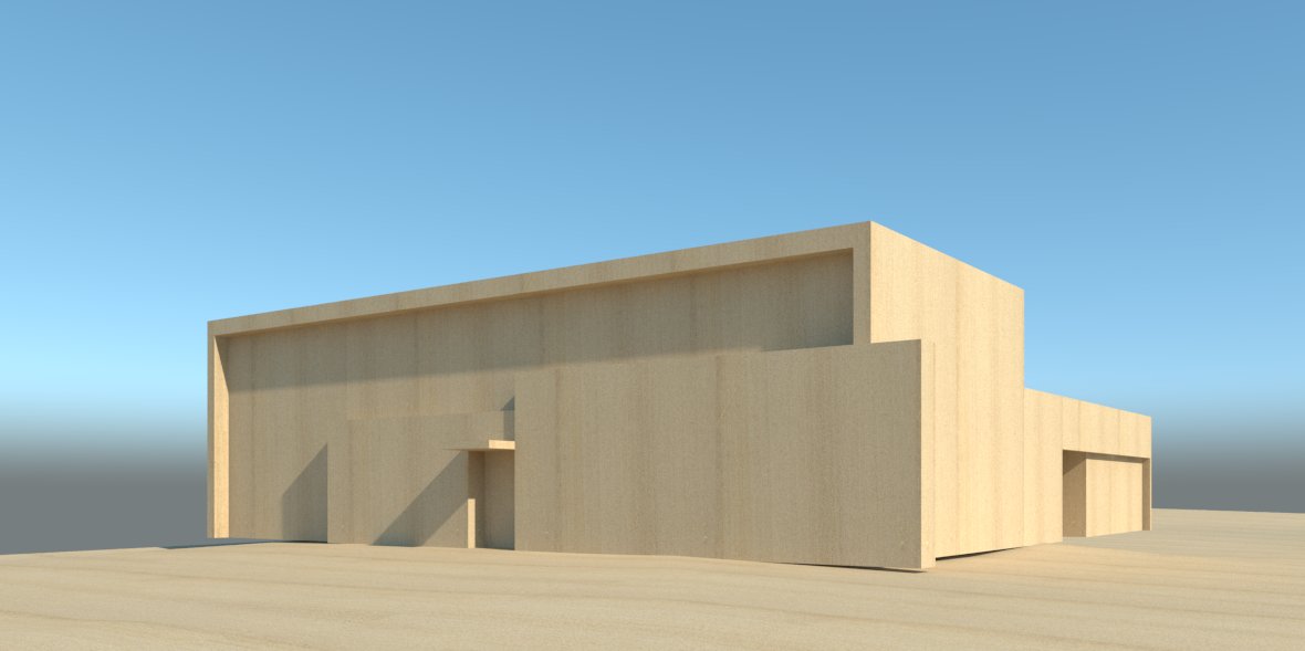

    I am VERY new to VRay and am testing out the Beta for Revit. Is there a simple way to change the background in the render to a plain white instead of the default blue/ grey gradient? I am rendering a "basswood" massing model. Thank you
