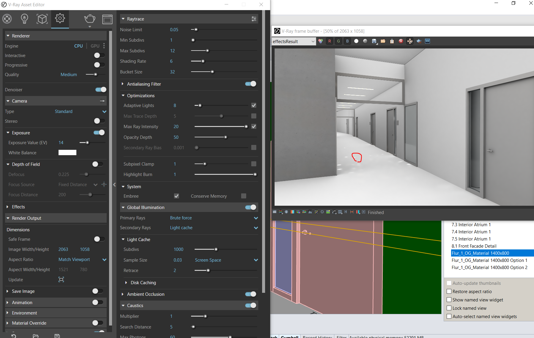

    Hi Guys,
    I am trying to figure it out but have some problems with it. I cant get rid off these white splotches on the floor. I know this topic was talked about many times before but somehow I cant find a solution to it. Any ideas ?
    Rec Lights in the ceiling double sided invisible
    Most of Materials simple white
    Rhino 6
    Vray 3.6
    Windows 10
    Best,
    Jarek
    Hi Jarek,
    What are your Primary/Secondary rays settings? Keep in mind it is advised to use Brute Force/Light Cache for optimal result.
    You can send us a scene to support@chaosgroup.com so we can investigate further. Thanks!

      Dear Nikoleta,
      Thank you for fast reply. I am not sure if you see my attached image. I will upload it here again.
      Primary - Brute Force
      Secondary - Light Cache
      I have send you the packed scene as well.
      Best,
      Jarek

        Hi Jarek88
        Why do you have caustics on? Turn them off, the splotches you see are most probably caused by caustics...
        First of all Set the Sample size in light cache options to 0.01.
        Tun off ambient occlusion
          This is most probably the issue.
          I also don't see any reason for Caustic calculations in this scene.
          Konstantin
            Thank you very much, that worked very well !!
