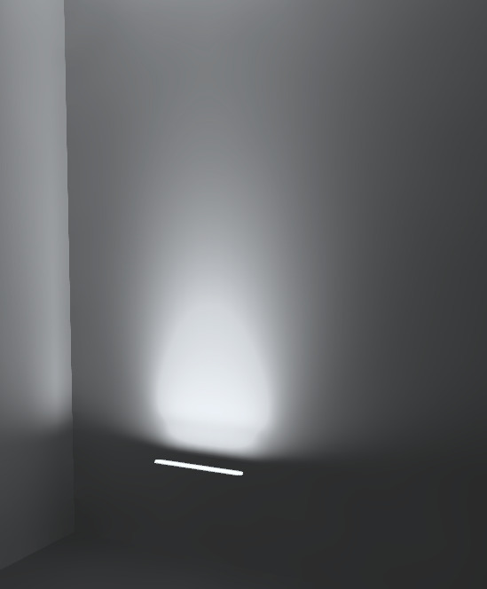

    - Simulation image made with Dialux Evo in which you can see the correct light distribution along the entire linear surface of the LED bar in order to compare the Vray simulation
    - Simulation image in Vray of my project in which it is evident that the photometry ies is distributed only in a spot way in the insertion point.

        I downloaded the last Vray for Rhinceros 7 Version 5.20.04 (with last update of Rhino 7 SR14 2022-1-10). It seems that enamble ies soft shadows is hidden again. In addition the python script you gave us last year doesn't work, please see attached image.
        I'm not python expert so can you kindly correct the script to allow us to better use the soft shadow option.
