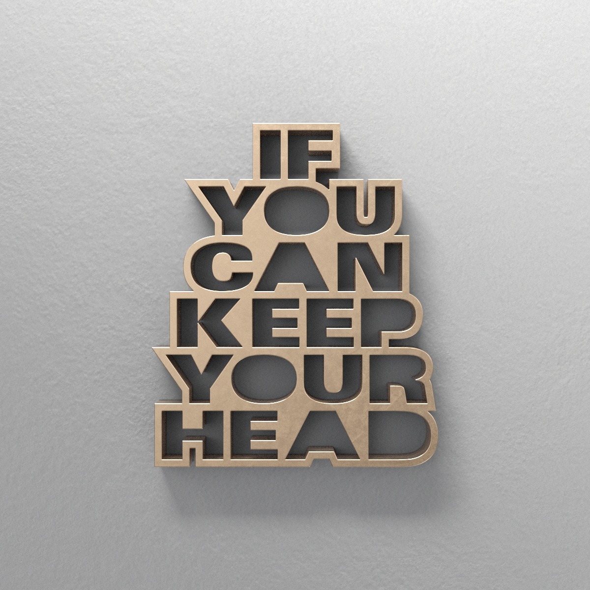

    Create a scene in Rhino with a bunch of rectangle lights. Set up the exposure to certain values and hit render. I get the following image:

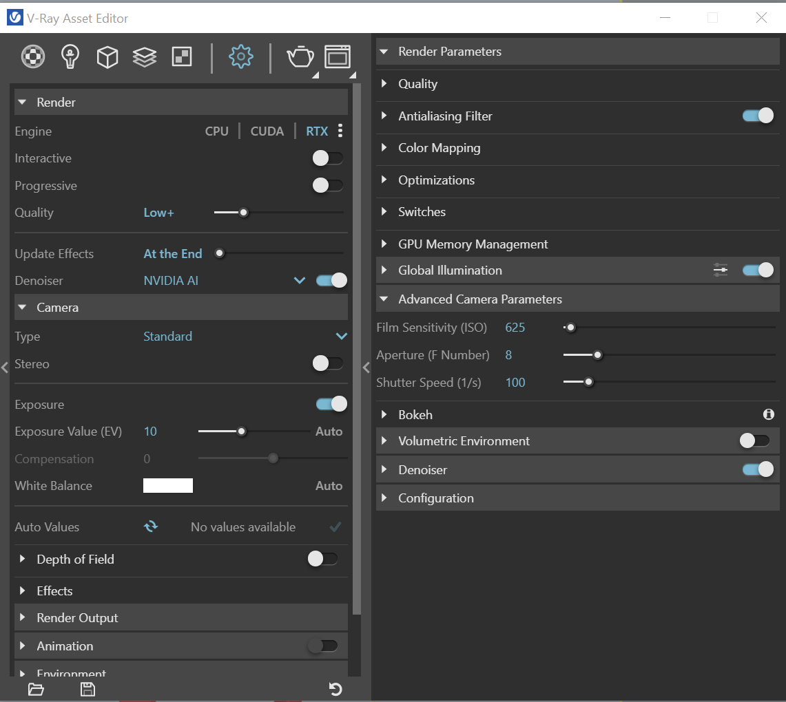

    Here are the settings:

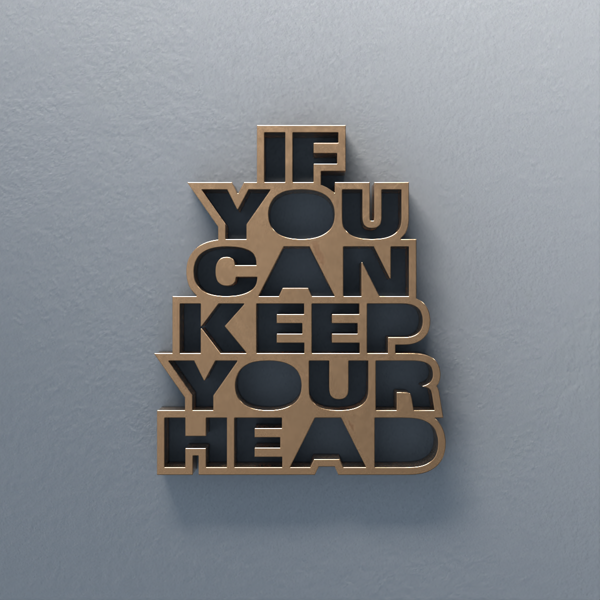

    If I hit render in Grasshopper I get the following image:
    As you can see its a lot darker and cooler with a hint of blue.

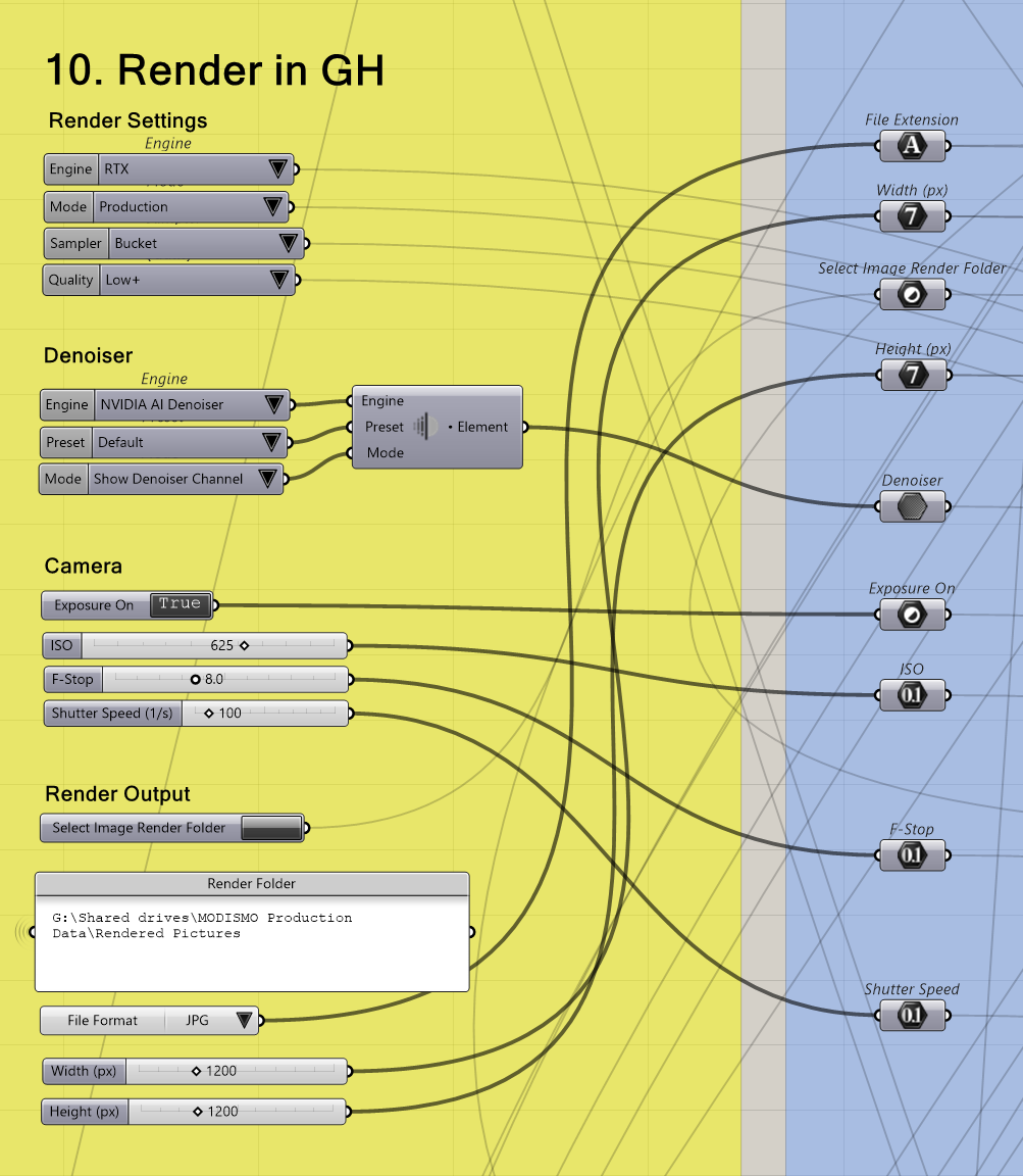

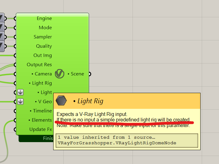

    I think I found the error:
    Click image for larger version  Name:	light_rig.png Views:	0 Size:	57.3 KB ID:	1110362
    V-Ray for Grasshopper adds a light rig if nothing is connected. This seems to be some sort of sky texture, as it tints everything in this blue color.
    I think if it is rendering a .vrscene file with "lights on" it should not add that default light rig. Why have a default light rig anyways? I think it creates more confusion than what it solves.
    Or rather, shouldn't the background environment texture be part of the .vrscene file?
    It seems like the Render in GH node ignores the background environment from the .vrscene file and adds the default light rig in there instead.
