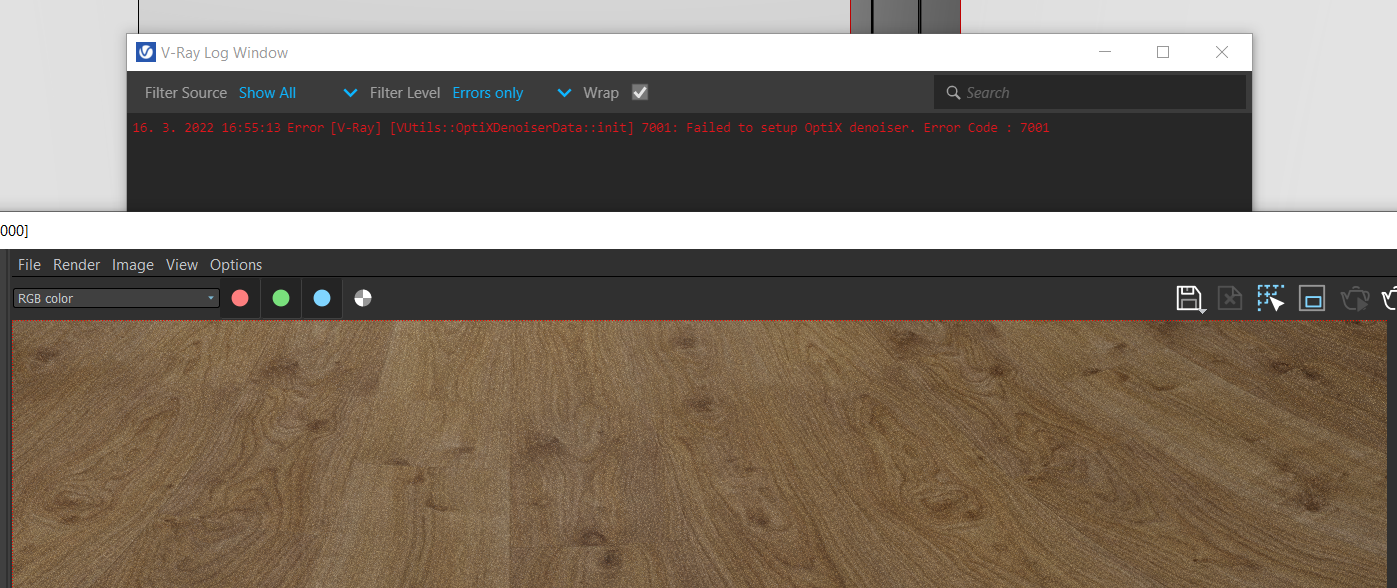

    Hi, yesterday I found some bug with Optix denosier.
    I tried to render VR Spherical panorama 6000x3000px, render engine set to RTX and denosier set to NVIDIA.
    At the end of bucket rendering it shows Error - Faildet to setup optix denoiser. Error code: 7001.
    By setting denoiser back to Vray I have no issues at all.
    Hi pavol_pastork,
    I was not able to reproduce the described issue here.
    It is possible that updating your GPU drivers resolves the issue.
    Note that most of the Nvidia AI denoiser code is actually in the driver itself.
    To check which driver version is the currently recommended one you can go to the following link - https://www.chaos.com/vray-gpu
    At the time I'm posting this it is - 497.09
    Hope that helps,
    Konstantin

          I had a similar error years ago (on Max but same error) and it seemed to be a result of the card running out of ram. Never did find a solution other than reverting to vray denoiser.

            I think that it could be the same issue. It happened with interior scene with dome light, plane lights, emmisive materials and some high poly meshes. I test it with another scene.
            Question: Does the Nvidia denoiser use the whole amount of VRAM of 2 GPU? 8GB+6GB
              Yep, the error is the result of insufficient memory but I cannot guarantee what is the cause (the large output resolution, scene composition or settings) unless there is a scene file for investigation.
