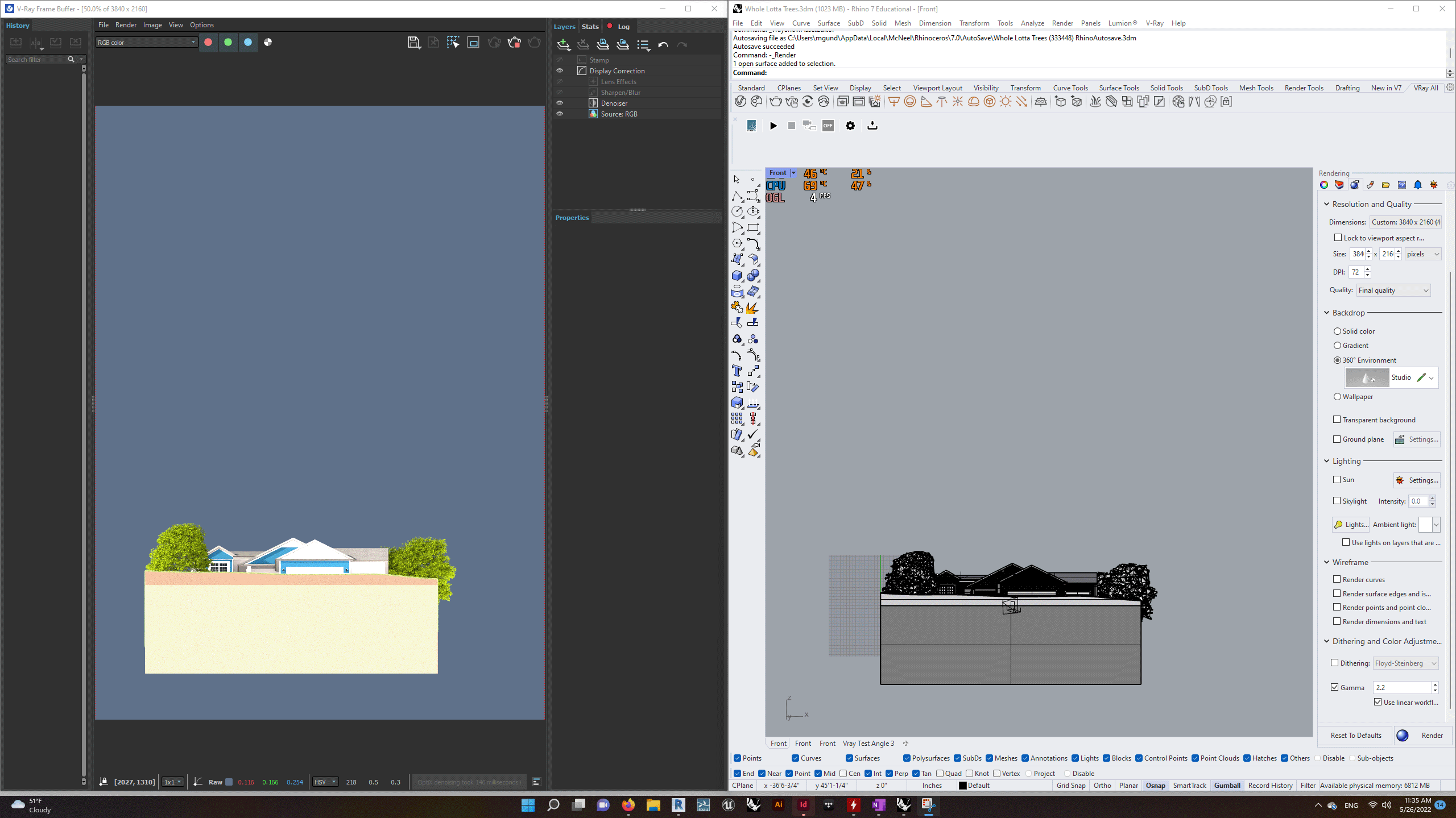

    Hello everyone,
    I have a minor problem with a render set: I have imported a HDRI sky for my environmental background; however, the scale of the HDRI or my model does not place it in elevation frame. When I tilt the camera 65 degrees up, the blue sky is visible so its there. I do not know how to scale it to be within the background of the model. Would anyone know a fix. Attached are some images and my setting:

    I figured it out. Rhino camera was in a parallel view instead of perspective...
      Dear matthew_gundershaug, hello.
      As far as I see your examples are renders from Ortho views. Please take a look at the very good explanation here.
      If you try rendering from a Perspective view, you will see the difference.
      In you case (if Ortho is necessary), I could recommend using Background (as a color correction layer) directly from V-Ray Frame Buffer, see here.
      You could try there different opacity levels and placement. Keep in mind that this approach is similar to a collage, so don't use images meant for spherical projection (like spherical panoramas).
