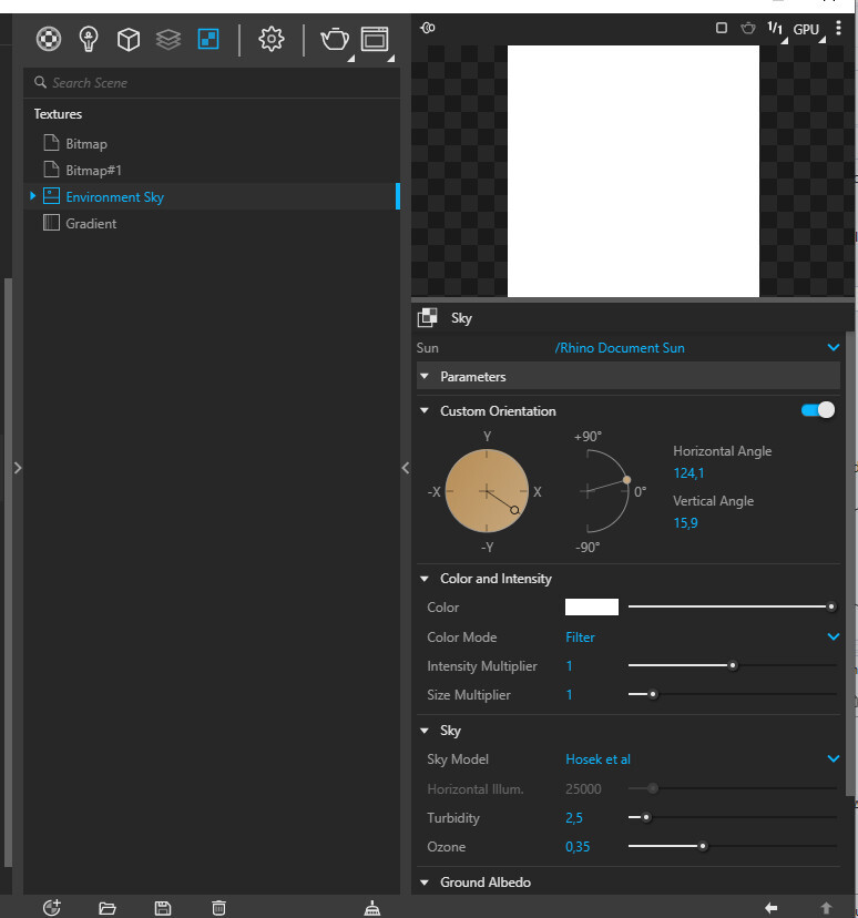

    Or, if i try to put a sky in Vray, using in the settings, "Environment-> Background", it is impossible to do: or it is black, or, if i try to choose "sky", i have none picture in the panel, at the right preview, the texture is only a white rectangle?????????????????

    I think there is a bug. Set the intensity of the sky to 0.025 and the preview shouldn't be white anymore. Try to find the right intensity for your scene.

      To achieve a natural sun lighting with a sky background you need to use Sun together with a Sky texture slotted in the Environment > Background map slot. Enabling the Sun gives you only a direct light, the background and the diffuse light comes from the Sky texture. Generally you need an Exposure value around 14 for a daylight exterior scenes when using Sun and Sky.
      The preview of the Sky texture in Asset Editor appears overexposed most of the time, because it represents its intensity accurately and most pixels exceed the value of 1. Our dev team will look forward improving this.
