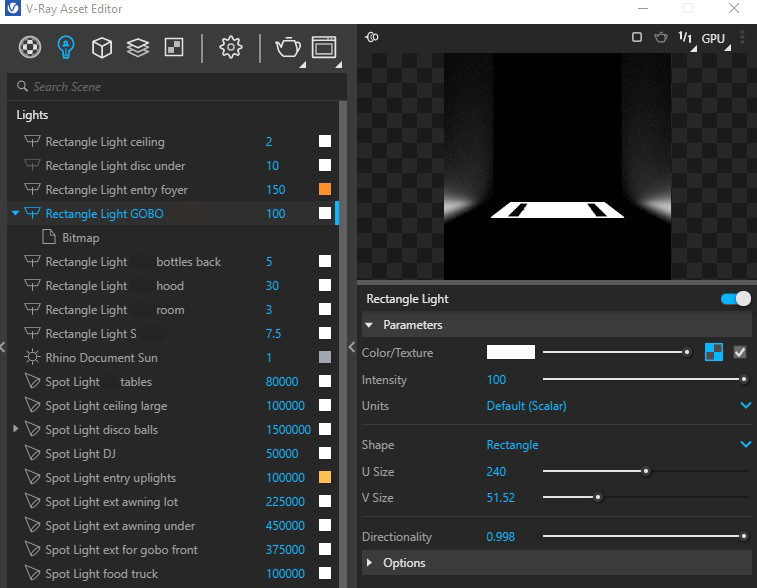

This happened a couple weeks ago. Created a light with a bitmap in texture slot. Production CUDA (CPU & GPU) render. Used light mix on this light and other lights. Then "to scene" to save light settings.

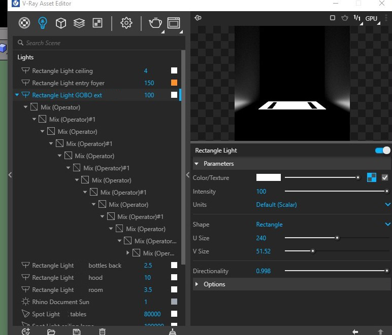

2 attached images show light before & after corrupted light mix.
File then became excessively slow to open, and render, a several minute pause.
To fix temporarily, I deleted the affected lights, importing the file into a clean Rhino file, remade the lights, then didn't use light mix when I have textures in any light slot. File then rendered fine.
The same situation occurs when I used procedural noise "B" in the texture slot (simulating a disco ball light effect on walls & floor).
Shown light is rectangle, also corrupts with spotlight.
