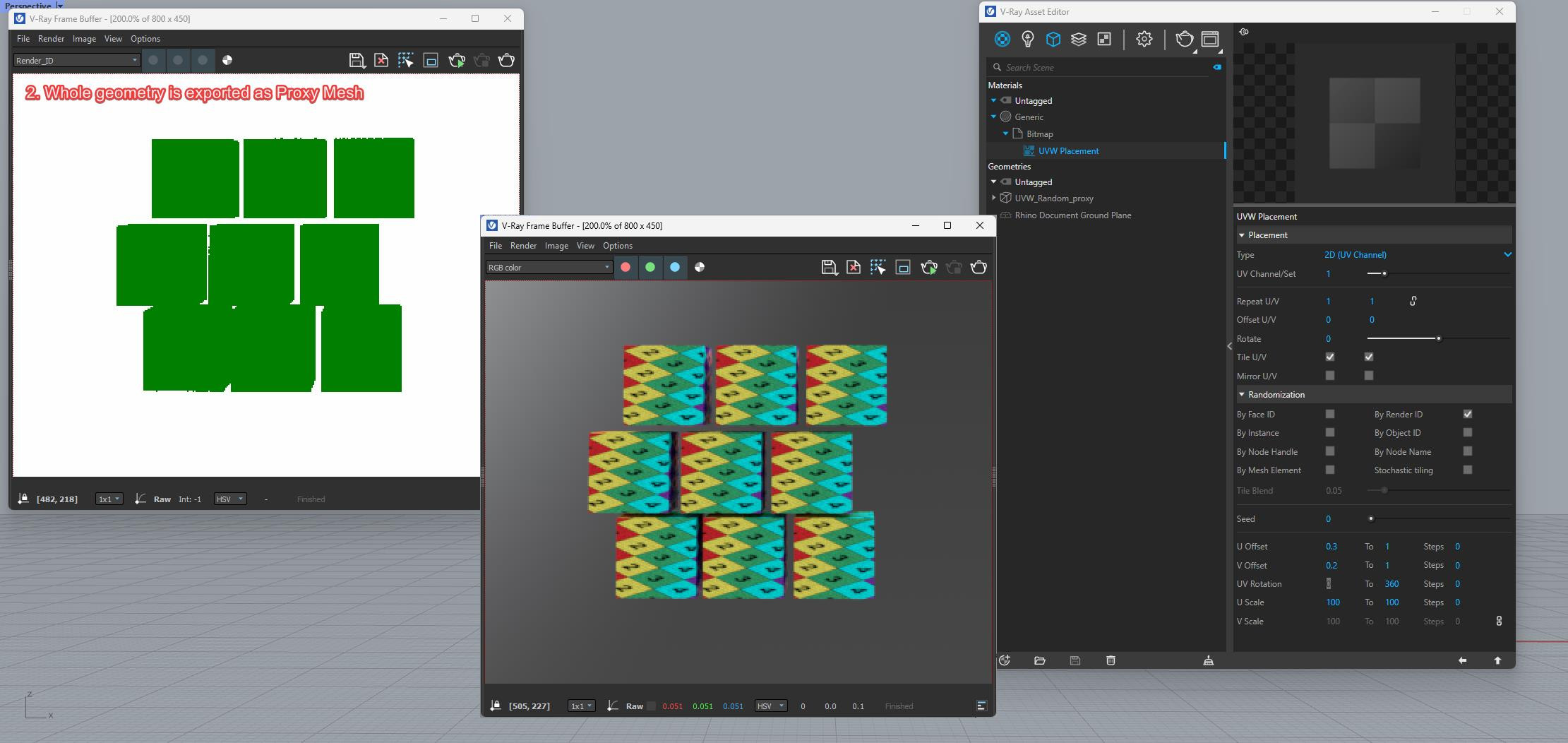

    When you export the whole geometry as a .vrmesh single Render ID is being applied to this Proxy Mesh. You can add the Render ID render element to see the difference before and after exporting.
    Randomization is a render time effect that Proxy Mesh does not store as an information.
    That being said you have two options:
    • Export your whole geometry as a .vrscene. In this case you can set UVW Randomization to By Render ID, By Node Handle or By Node Name. Information about materials will be stored in .vrscene and you will get the same result.

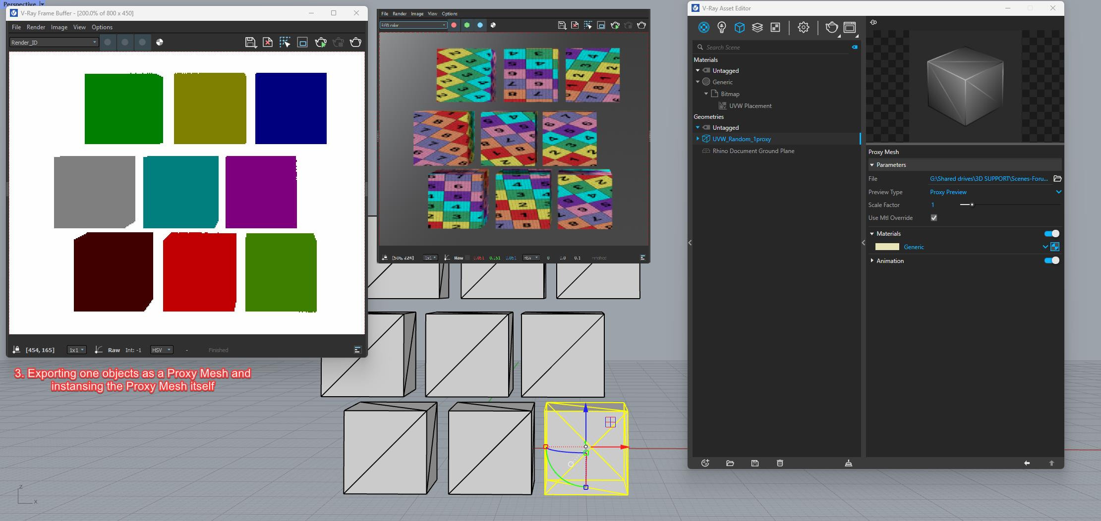

    • Another option is to export one object as .vrmesh (box in your case) with By Render ID option and instance the Proxy Mesh itself the way you need.
ID:	1179794 Click image for larger version
ID:	1179795Click image for larger version
ID:	1179796 Click image for larger version
