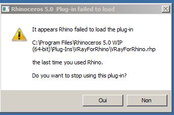

    I have this problem since this morning. Rhino fails to load the Vray. I updated my Rhino and Vray with the latest builds but still cannot run the renderer.

Name:	vray loading problem.JPG

          you have to reinstall vray in programfiles/beta this is where now the new Rhino installs,earlier it was programfiles/wip

                  I've just discovered that renee81 got it right, you need to reinstall V-Ray to the Program Files/Rhinoceros 5.0 Beta folder rather than Rhinoceros 5.0 WIP, which seems to be the default in the V-Ray install. I've just done this and it's fixed the problem straight away. It would be nice if there were a sticky telling people how to fix this, it seems to be a common problem.
