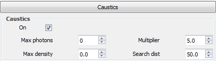

My caustics settings are :

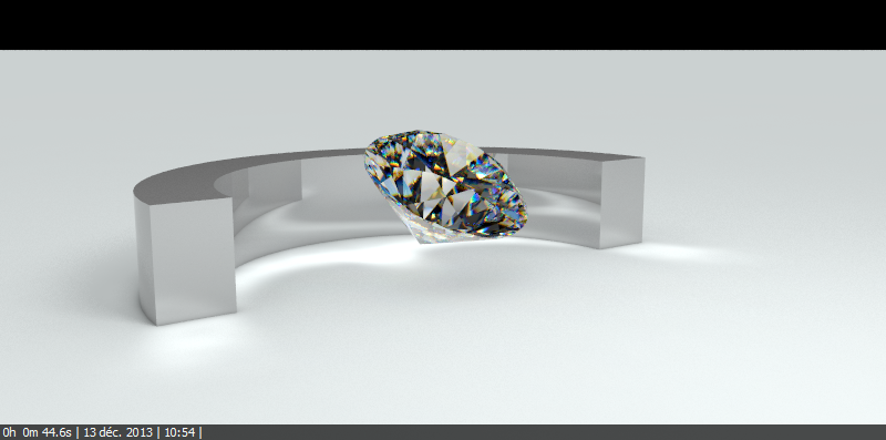

For the first image, i used vray old standard material, and setup for being a diamond material.
You can see Caustics under the diamond.
Second is rendered with new VrayMtl, no caustics under the diamond.
And the third is rendered with Vray Express Diamond setup, little caustics under Diamond, but just white light.
