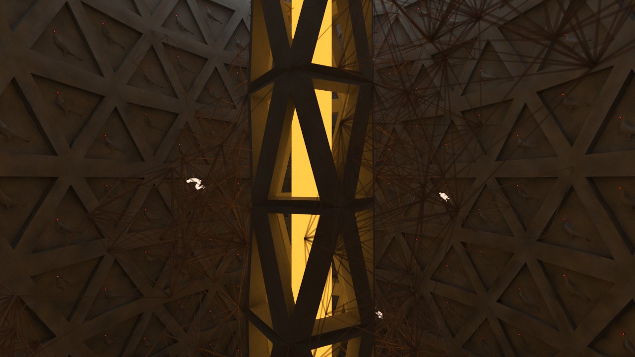

    First I render the scene from file named HealingWomb.3dm
    This is what i get:

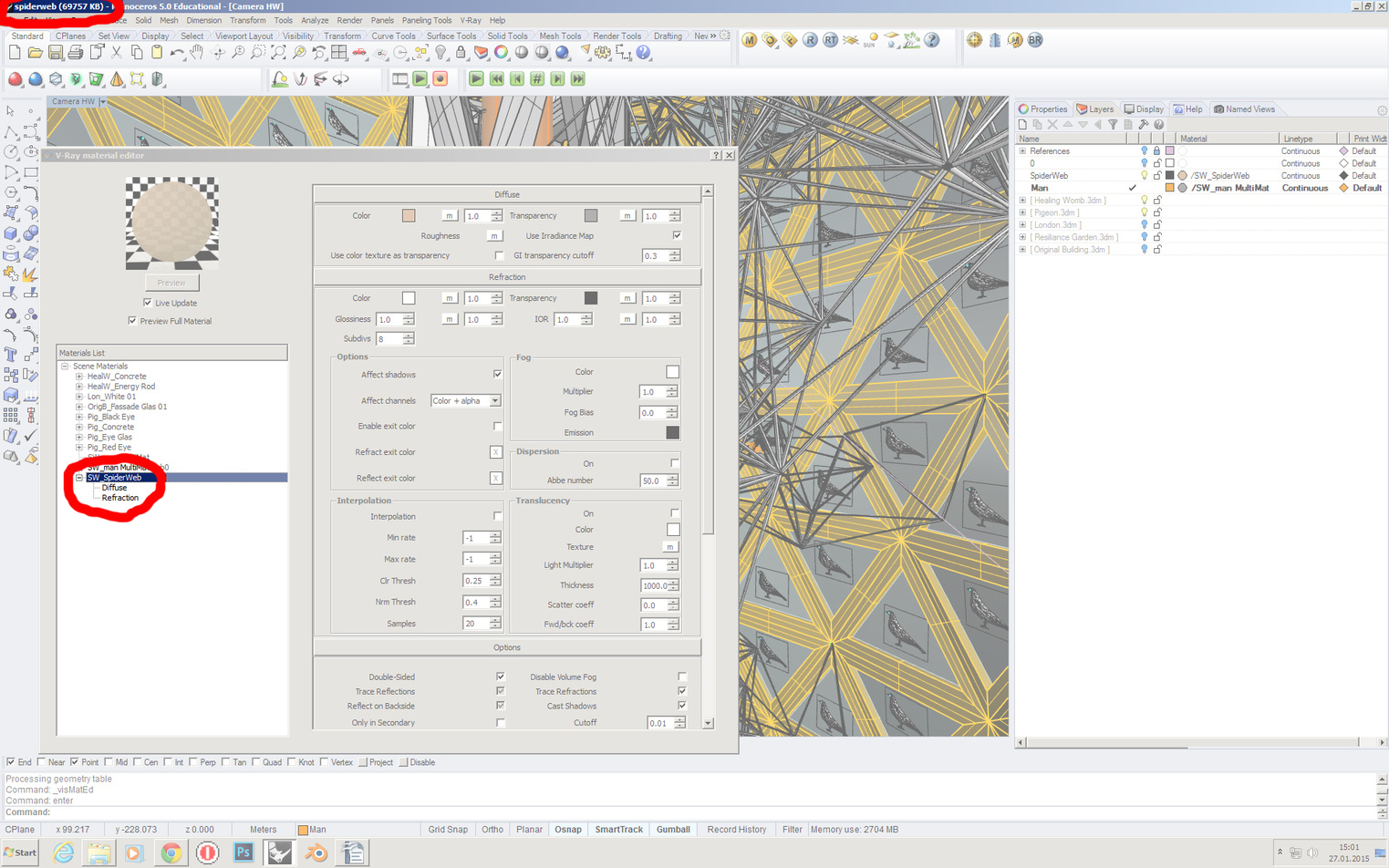

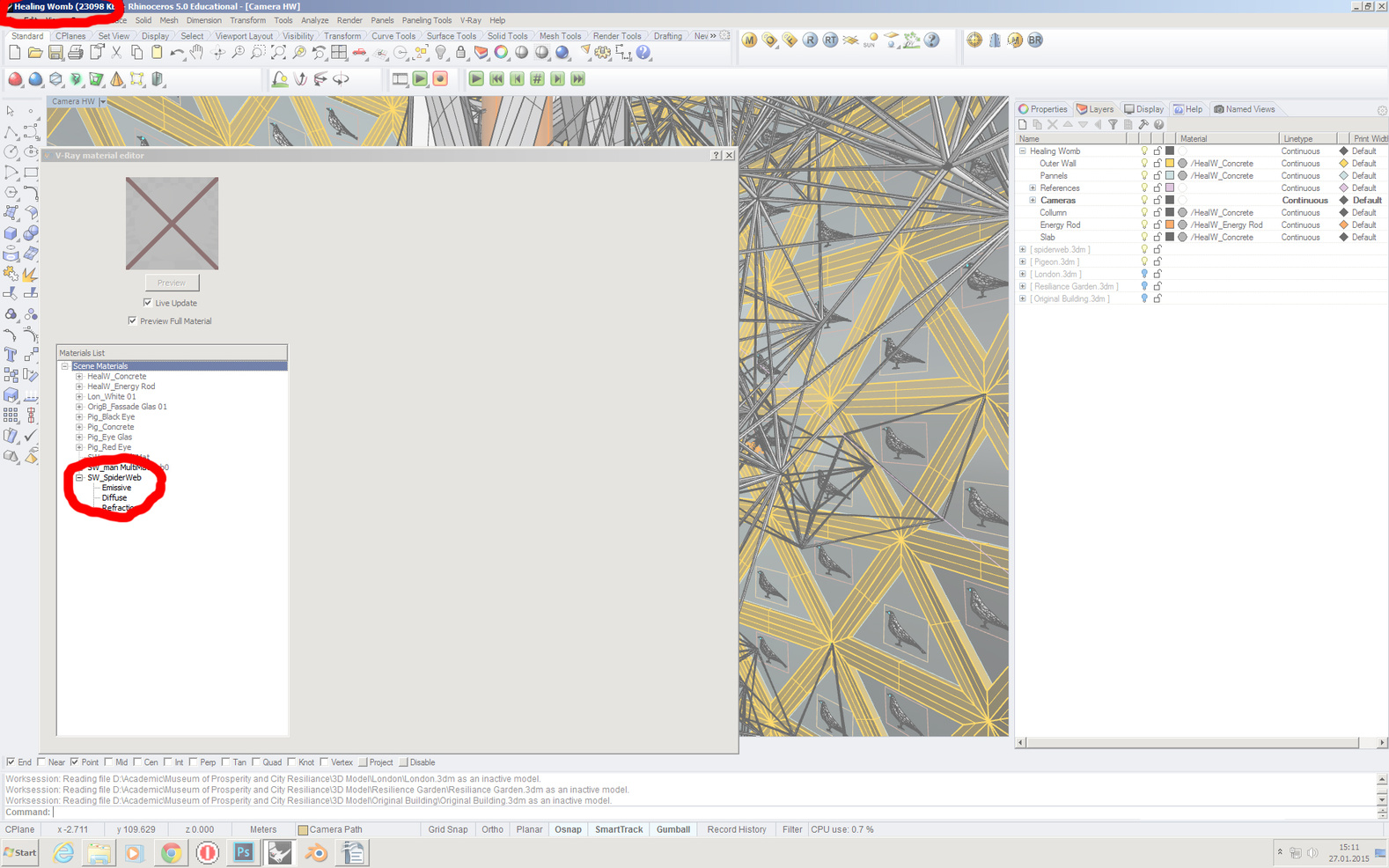

    While still being in HealingWomb.3dm I than add emittive layer to material used on a object in another attached but inactive file called Spiderweb.3dm
    This is the result rendered while Healing Womb.3dm is active model.

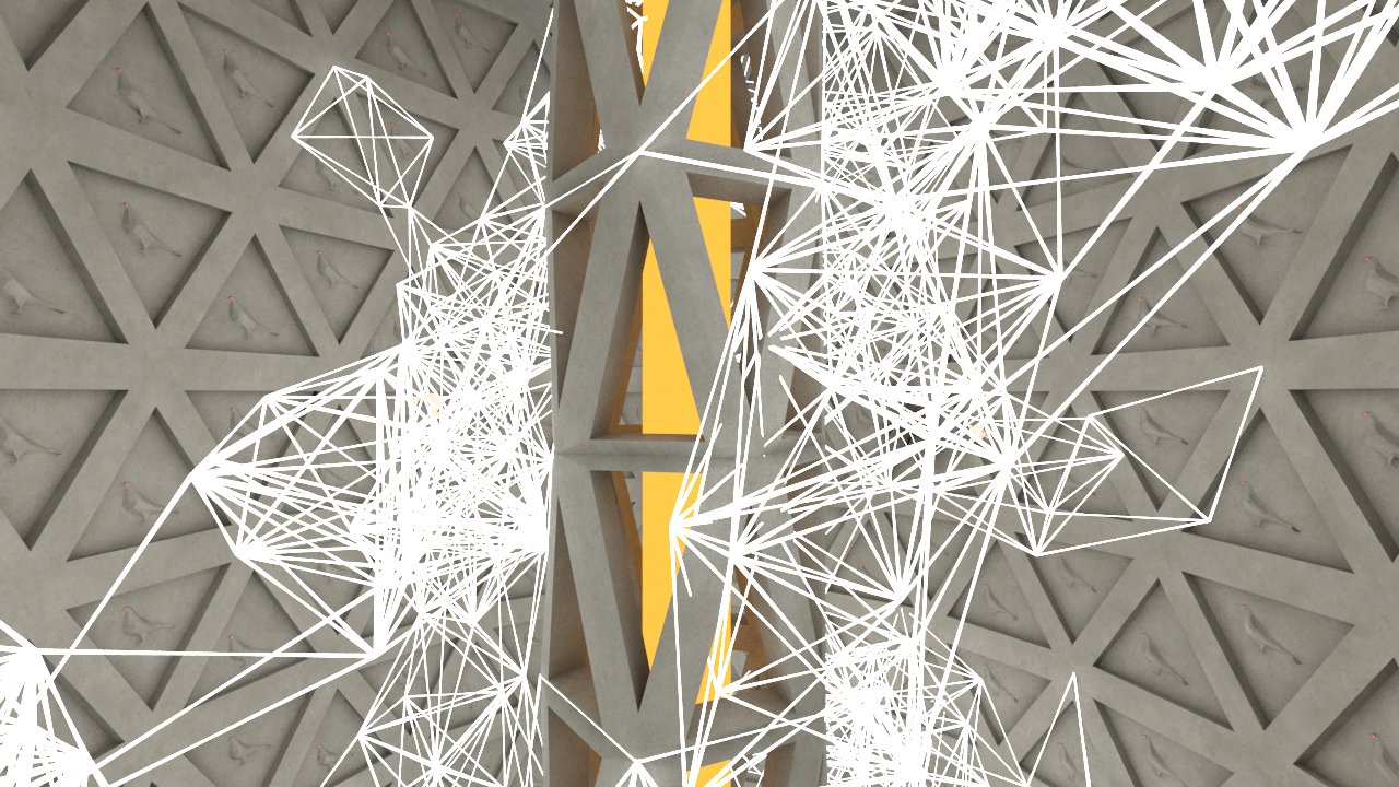

    I than Switch my worksession to be active in Spiderweb.3dm to find out that the material Change i did in healing Womb.3dm didn“t change in Spiderweb.3dm und thus renders like the very first Picture
    Same bug appears when I change material in Spiderweb.3dm and than render in HealingWomb.3dm
