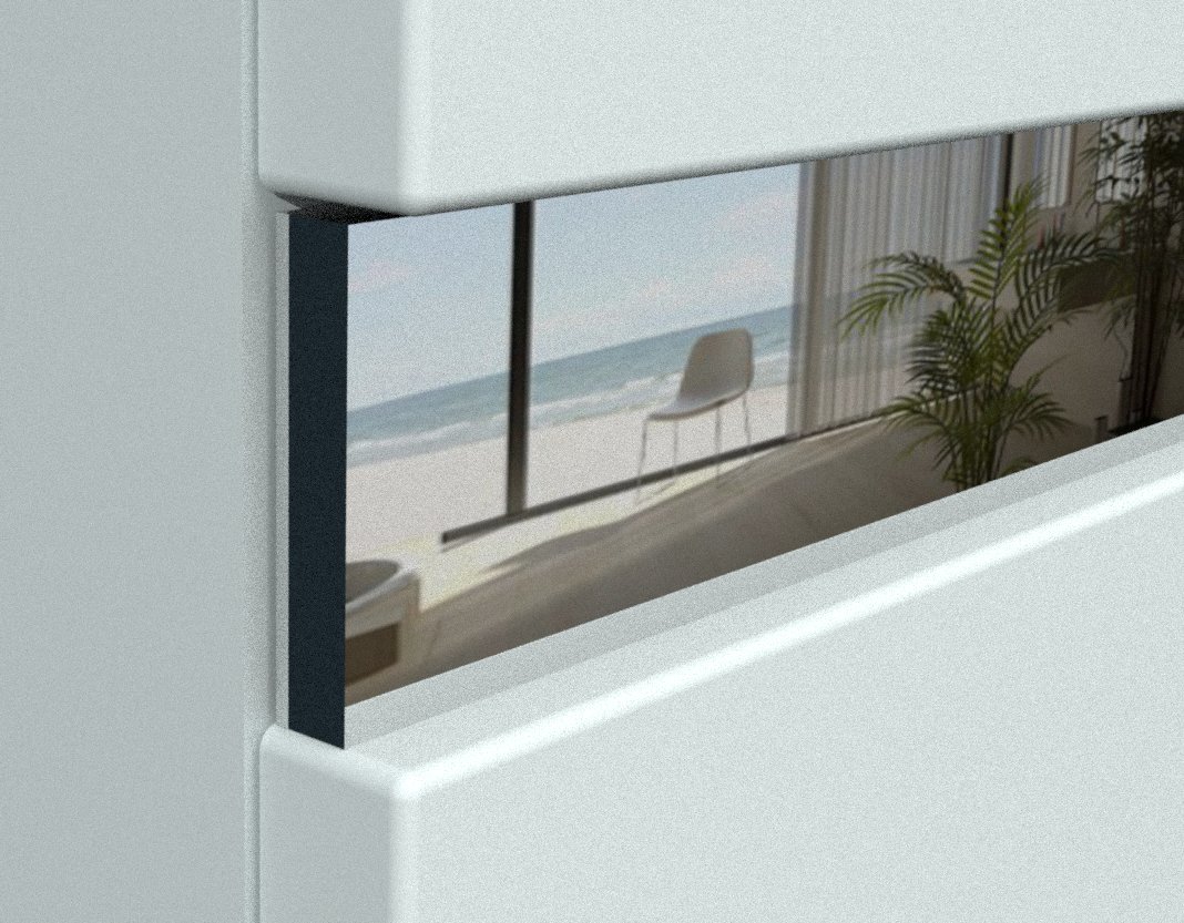

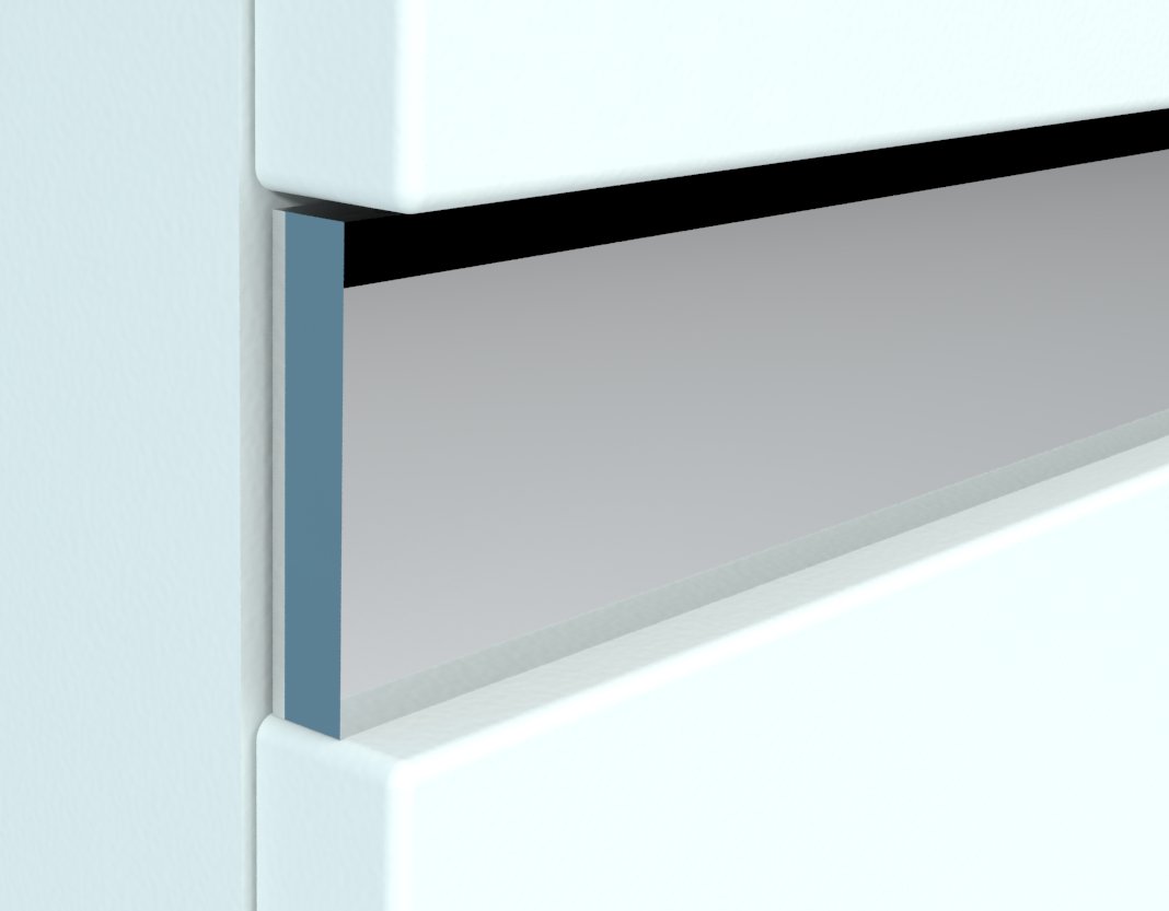

    I have a plane with a image texture mapped to it. I can get a chrome object to reflect the image with the RT Engine but not the Render engine; the render does not reflect the image it is just grey!!. Anybody got ideas on how do I resolve this??? steve
    I have solved it....it seems to be the material with an image texture mapped, that I was using as a wall to reflect that has stopped working. I had used a material from another file that had worked before but when I saved the material and loaded it and then attached an image it would not work with the render engine but would with the RT engine. I made a material from scratch and it was fine! I am not sure why I could not use a material I had saved from other file........most of the time this works. steve
