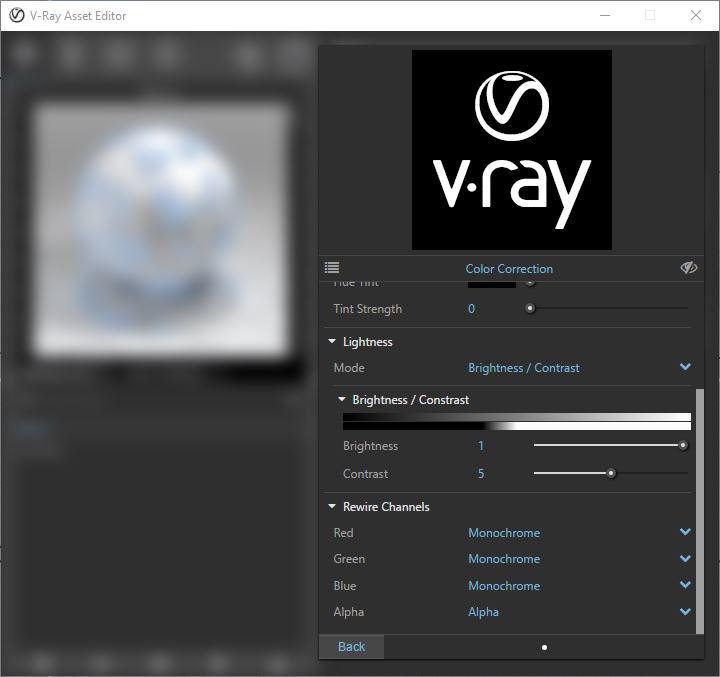

    4. Rewire the RGB channels in this case to Monochrone and adjust the Brightness and Contrast parameters accordingly to create the Blend mask.
    Adjustments may vary depending on the source image used.
