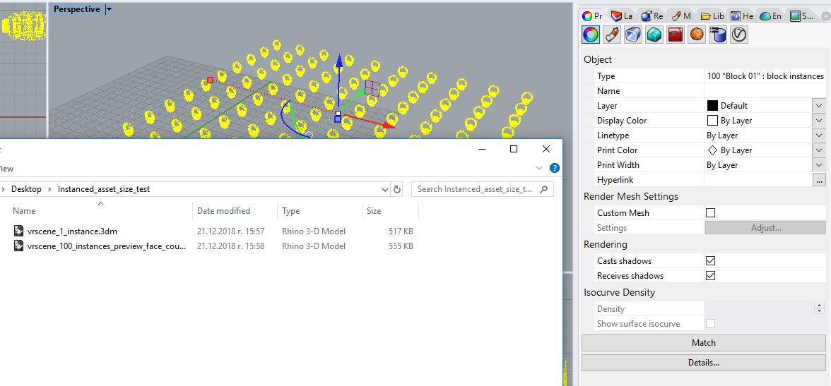

          How exactly do you instance the imported .vrscenes? If you are instancing the blocks they're in, you should not see any substantial file size increase:
          Furthermore, how do you imagine your ideal workflow when working with Proxy assets in Rhino and/or in relation to Grasshopper?
          We will be discussing all this in early January. Your feedback is welcomed!
