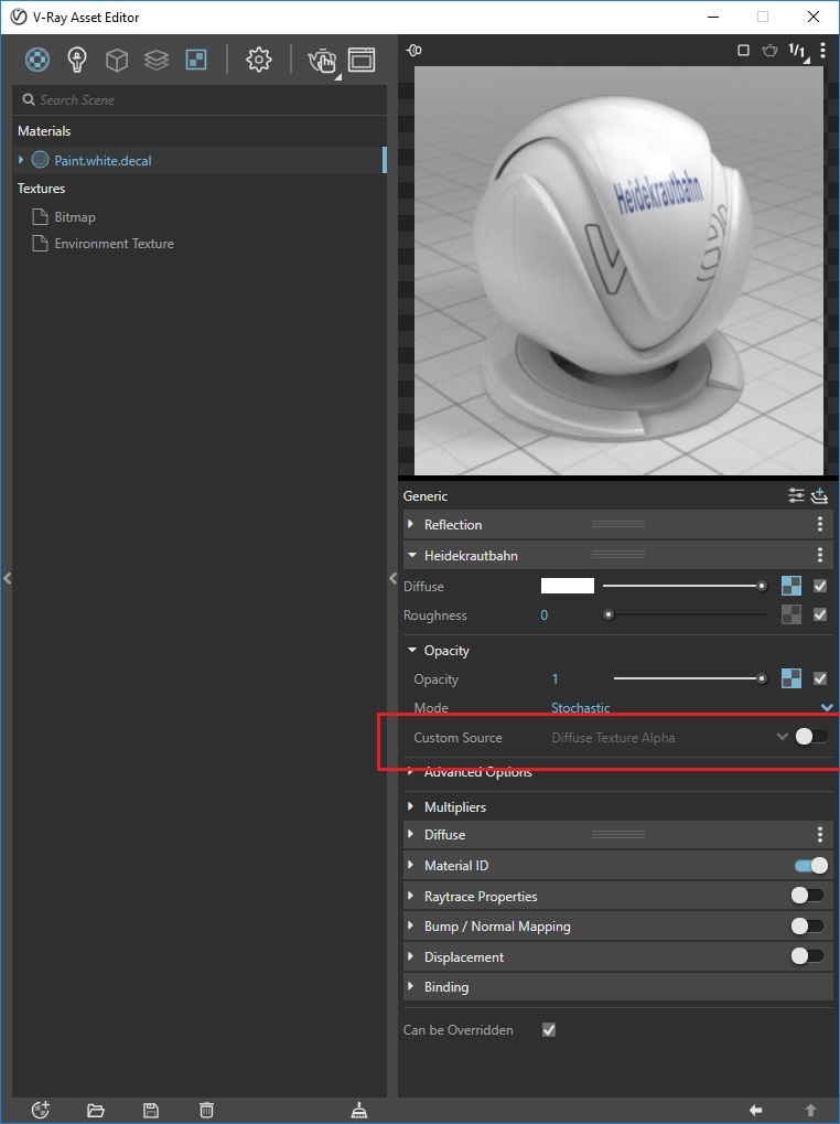

    Hi,
    I tried to use the alpha from the PNG, but it doesn't work, the alpha is semi transparent only. Did I something wrong?
    -Micha

      Hi,
      The way an alpha appears (white/black/glitched) depends on the software used to create the PNG file in the first place. As a workaround, you can try the following steps. The first one is about Opacity map. Slot there your png file and wrap it in a Color correction texture. In the Color Correction, go to Rewire Channels, for RGB channels use Inverse Alpha (01).
      Click image for larger version  Name:	01.jpg Views:	2 Size:	80.5 KB ID:	1036659
      After that go to the Bitmap - Color Manipulation and enable "Invert Texture" and "Invert Alpha" (02).
      Click image for larger version  Name:	02.jpg Views:	2 Size:	76.7 KB ID:	1036660
      The second thing is to disable the Diffuse Texture Alpha (03),
      Click image for larger version  Name:	03.jpg Views:	2 Size:	98.9 KB ID:	1036661
      the png file doesn't have its channels properly set and that is the reason you don't get the expected result.
      We know that this is not the best solution but it will save you from modifying the texture in external image-editing software.

            Hi konstantin_chaos ,
            thank you for the insight. Interesting maybe that I found ways to get it work. First I setup the material at VfR2, since I know, there I get what I need. Later I load the material to VfR4 and I was surprised - it works. So, I finished my project.
            Today I tried to find why it works on this way and I found the key option - it works if a transparency map is used and the default color is right set. Per default the color is a medium grey and so the range around the decal is half transparent only.
            The opacity by texture alpha can't be used since the default color for the embed alpha can't be set. A simple solution could be if internal it would use black instead the current white. An other solution would be a default alpha color. But also if the default alpha color can bet set, I tried to create a material per VfR2 and I was surprised again - it works too. So, it seems to be an internal setup problem only. Attached the material for this kind of setup.
            Additional the viewport of Rhino 5 and VfR2 shows no tiling if tile is disabled at the Vray material. At Rhino 6 and VfR next the texture is still shown tiled. I hope this could be fixed too.
