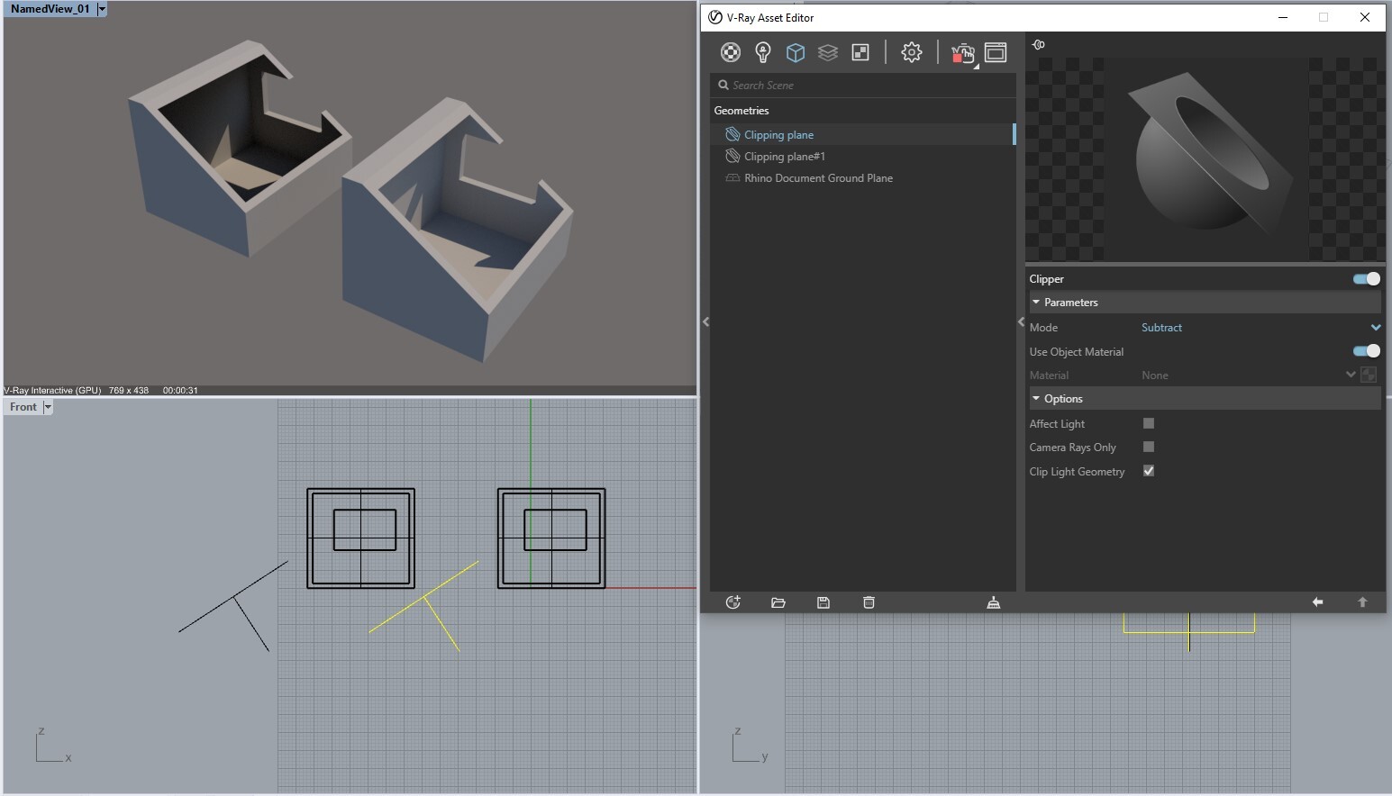

    Can I clip the sun light with Clippingplane, and keep the window sun light? Click image for larger version

    Hi pun1407
    Disable the Affect Lights parameter in the Clipper's Options rollout.

      Hi Georgi,
      Oh, I see, this function is cpu only.....! that right?
        The control to omit light through section cuts also works for V-Ray GPU (both CUDA and RTX).
        Can you please advise what V-Ray for Rhino version you use?

          Hi, Peter
          I am using Rhino 6 sr27 and Vray 4.2.002 and 4.2.003, thank you!
            You should have no trouble using this functionality with V-Ray GPU.
            If you are not able to achieve the desired result, please check the render log for warnings or errors.
            Kind regards,
            Peter
