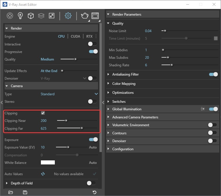

    Hi Micha,
    After you run the following script
    Code:
    import rhinoscriptsyntax as rs
    import System
    rv = rs.GetPlugInObject("V-Ray for Rhino").Scene().Plugin("/RenderView")
    rv.Param("clipping").Value = System.Boolean(True)
    you should be now able to see the UI controls in the Asset Editor's Camera Settings - see attached image.
    Click image for larger version  Name:	vrayneui_2021-03-26_10-30-02.jpg Views:	0 Size:	77.8 KB ID:	1108711
