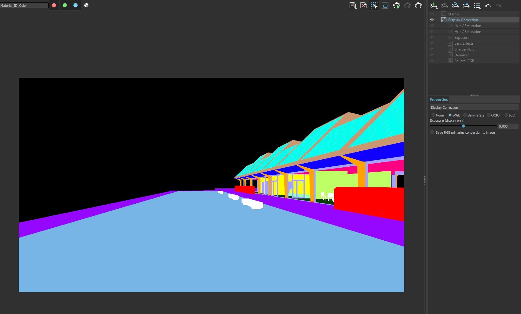

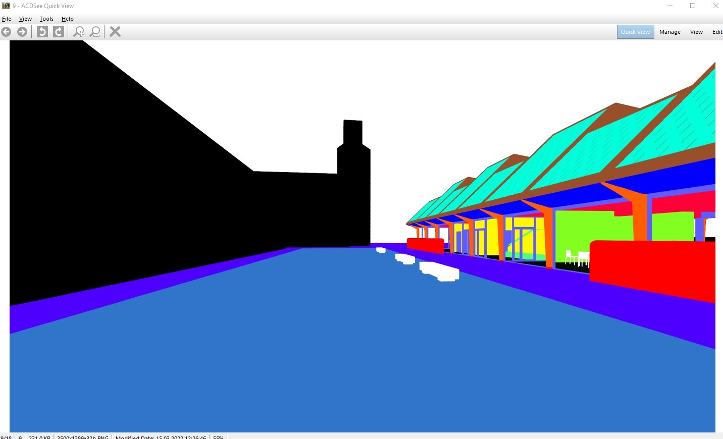

    I have a problem when I save my Material ID Color for Vray Frame Buffer.
    the color are not the same between what I saw on my screen (printscreen 1) and what I get in the saved file (printcreen 2).
    it seems that the display correction in SRGB is not applied in the saved file.
    can you tell me what is the problem ?
    thanks a lot for your answer.

    Hi tsponti,
    The display correction is not applied to the mask channels by design.
    In this case (material ID Color) however it might make sense to be applied.
    We will revisit this behavior and make a change if we determine it's necessary.
    Thank you for bringing this to our attention.
