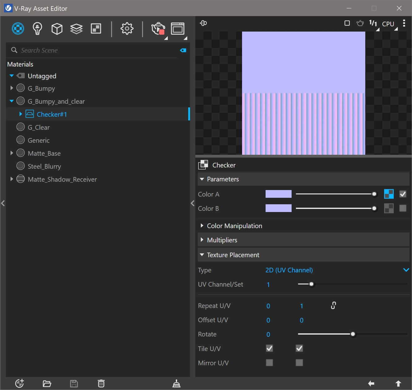

        The fix I was able to apply involves UV manipulation and a single material with a slightly more complex bump/normal map.
        Here's what I did:
        1. Ensure that the UVs of the inside and the ones of the outside are separated in the 0 to 1 UV square:

        2. Ensure that the normal map is split in two so that the stripes are visible only on the bottom halve of the texture like so (done procedurally):

                    Hi guys,
                    After an internal discussion it became clear that using two separate materials would never work.
                    The reason is V-Ray only calculates the correct IOR when the ray enters and exits the same exact material.
                    I also want to note that there is one alternative to the solution I showed earlier, one which does not require UV manipulation.
                    Here's the idea:
                    1. Split the interior surface
                    2. Assign Object ID (1 for example) from the V-Ray's object properties panel
                    3. Use a Multi-sub texture in the material's bump slot
                    4. Add two textures
                    5. Set the default bump/normal color in slot 0
                    6. Add the interior normal map in the second slot (ensure that the Transfer Function of the bitmap is set correctly)
                    7. Apply the material to both the exterior and the interior of the glass
