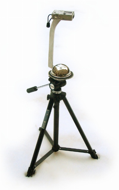

    First, I don't use a chrome sphere, I use a big soup ladle from R?sle (www.roesle.de). This soup ladle are approx. a half sphere - price approx. 20,-euro for 10 cm diameter. Most you will find this kinf of ladle in design kitchen stores.
    Very often I have seen that people shot photos in horizontal direction, but than a part of the horizon is missed. My new technic is to shot the image with the camera top down. So, only a part of the ground is missing, but most this can be easy retouched. For reflection/GI environments this small artefact at the ground is no problem.
    My english is not the best, here an image of my tool as discription:

    Nice micha
    Does that ixus have the ability to shoot with different exposures?
    The most important thing is like you have it, that the reflective object is attached to the tripod, that way your sure that it will not move relative to the camera. But on the other hand, you want to place the camera as far away from the ball as possible.
    Where ae you standing when you take the pics?

      Where I was?
      Two way: squat beside the tripod or hide behind a tree or something other (here helps a long timer time). Also you can see, my apparatus has one slight metal fixture for the camera. I have place this fixture so, that I can good retouch it later.
      Third way: some times, I was go away some steps and have hidden my behind the metal fixture. Per HDRShop and photoshop I have retouched the image.
