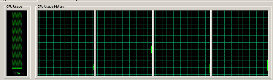

    Sounds like either hyper threading is off on your chip or is not an HT chip at all.
    we have a bunch of dell machines around the building, all appear to be the same but if you really look under the hood some are hyper threaded P4's and some arent.
    what do you get when you view your performance tab? I suppose there could be software related factors but this would be my first guess.

        The only place where you can really set how many threads will be used is during light cache calculations. Other than that vray should use all available threads for the rendering process. To set the number of threads used for lc calculations you should set the number of phases to the number of threads that you have available for rendering. However, LC calculations do not use buckets, so you wouldn't visually see any difference in the render process (although the vray log tells you that there are more threads to be used and of course the task manager)
        There also may be issues with memory as well. Basically if there is insufficient physical memory then windows uses virtual memory which is a certain amount of data that is written/read to/from a hard disk. Once physical memory is full, then the task uses virtual memory, but it will have to wait for and write the information that goes to the disk. This causes a loss of preformance simply because of the flow of information. Personally I have seen my quad core machine drop to 25% processing when the amount of information simply becomes to large for physical memory. Of course how much memory is available for a single task depends on not only the physical availability but also the amount of other information that is contained within memory, so simply having other programs running while rendering will take up available resources and slow things down.
        As far a Hyper-Threading is concerned, I am not really 100% sure if it benefits really extend to rendering. The whole concept behind HT is to use unavailable processer power to process multiple peices of information. This happens through a virtual separation of different render threads. Basically if a given task only requires 80% of the processors resources, then the other 20% is used for another task. Ultimately this only really expresses performance benefits when combining two tasks with each not requiring 100% of the processors resources. In the case of rendering, which will use all of the available processing resources, the performance increases may be negligible if any at all.
