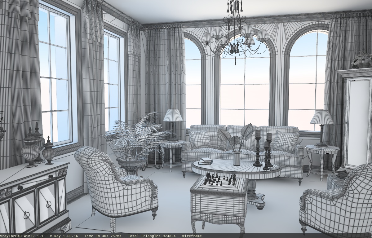

    Hi guys!
    I was wondering how to render wireframe in vray for rhino?Any help? It works on C4D or 3DMax but in Rhino..hmmm....I want to get a similar efect:

    That specifically is a V-Ray texture called VRayEdgeTex, which we don't have in VfR yet. The texture itself will render the wires of an underlying mesh and doesn't render the isocurves of a surface, which is more like you'll see in the Rhino viewport. You can use the toon material to do pretty much the same thing. If you're using a surface, just split it with the isocurves. If you're using a mesh just unweld and ungroup all the faces. Apply the toon material to the result in both cases.
