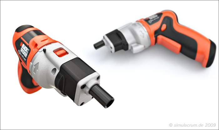

    I find Micha's B&D power drill http://www.simulacrum.de/images/B&D2.jpg to be a good example of black remaining black even though the floor is clearly white.
    I suspect that reducing the reflectivity of the dark object's material might help - and then compesating by using a suitable HDRI environment map for reflection and turn the multiplier up to achieve higher intensity?
