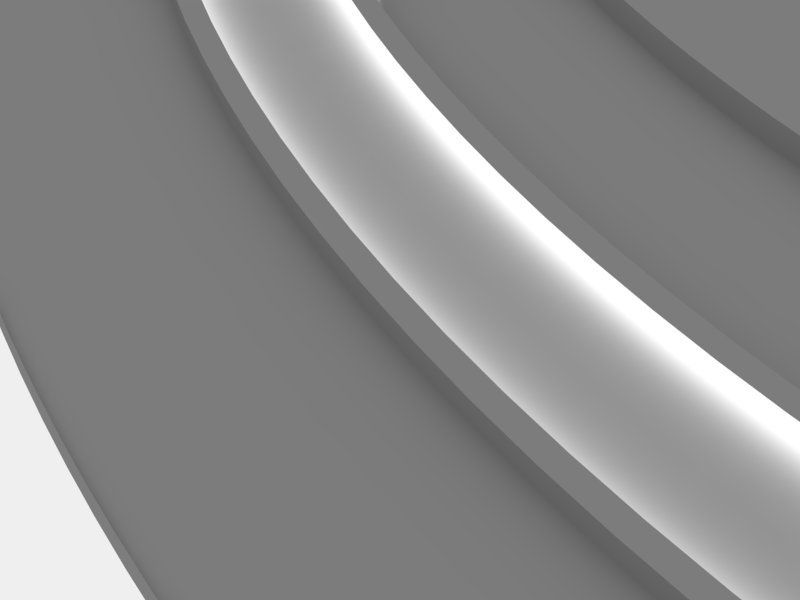

    Hi guys, I'm a newbye and I'm experiencing this problem with rhino 5 and the last version of Vray.
    Settings: Express_Very_High.visopt
    Light: Emissive material applied to a surface
    Near view - no problem -

    You can see the light through the shape in the far view
    ...and the more you get far with the camera, the more the light come out from the shape with blotches.
    How to fix it?

    Probably your IRMap is too low. Post your settings?
    emil mertzel
    vray4rhinoWiki
    Lookinglass Architecture and Design
      Check sample visibility? -> http://www.spot3d.com/vray/help/200R...vancedimap.htm
      or you could try to enable DE to avoid this light leaks
      At 1.5 the emitter layer can be set single sided (default), so that light goes in one direction only.
      www.simulacrum.de - visualization for designer and architects
        if you are using Ligh Cache you can also enable the retrace threshold to avoid the light leaking.
          Thank you guys.
          The problem has been solved enabling the retrace threshold and setting a deloney triangulation interpolation method
