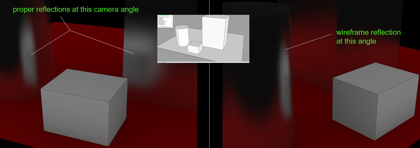

    When I render a toon material that is reflected in another shiny surface the mesh wireframe of the shiny surface shows up in the reflection wherever the toon material reflects. I am wondering why this happens and what I can do to fix it.
    Hello cantu.john866
    Is it possible to attach this scene ? You can delete everything and leave only the objects shown in the above screen-shot.
      I recreated a simple scene, it happens with any toon material. Though I noticed that it doesnt happen at certain camera angles.
        Thank you very much for the scene.
        I managed to reproduce the issue. It look like a bug - so I am going to report in into our bug-tracking system.
        I noticed that this issue is only happening on glossy surfaces - and you can workaround it if you select , Tread Glossy Rays as GI > Always from the Reflection Layer of the Glossy Material and the final result won't contain any visible edges.
          Awsome, thank you for the workaround.
