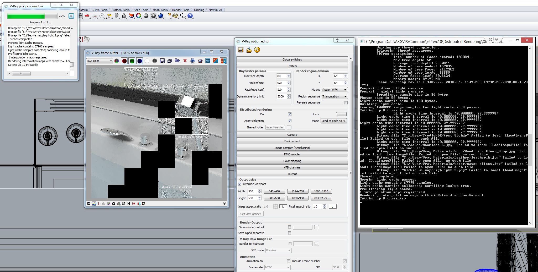

    My situation: At work we have a workstation (64bit Win7)which runs Rhino 5.0 with VRay 1.5
    We render a lot with this pc and bacause the renders took a long pretty long time, we decided to buy several render pc's (we first tested with another pc in the network (64bit Win7) and it worked fine.
    After having a bit of trouble with our system managers, we bought 2 Win8 systems and connected them (including the workstation) on a separate network.
    However, when running a test render, during the second phase we get black blocks. (only the blocks rendered by the 2 other systems though)
    I've added as much images as possible to make it extra clear for everyone willing to take a look.
    On the right is the XMLDRSpawner of one of the network pc's (vieuwed through teamviewer)

    Hello bnoo-
    There are several images that failed to load from your S: and C: drives. It appears that asset collection is not working for you. Have you tried using a shared folder method?
    Do the new machines have access to the drives that your maps are located on?

      My apologies for the late reaction, it has been kind of hectic around here.
      I checked it again and it seems not all systems have access to the network,
      this is not really strange because we have them on a separate network to keep the traffic off the normal network.
      This is however why I choose the option "Send to each node", hoping this would work.
      I have just created a shared directory on the the Rhino pc, which seems to solve this problem.
      Not sure why I hadn't thought of sharing a directory on the pc itself before.. Thank you!
