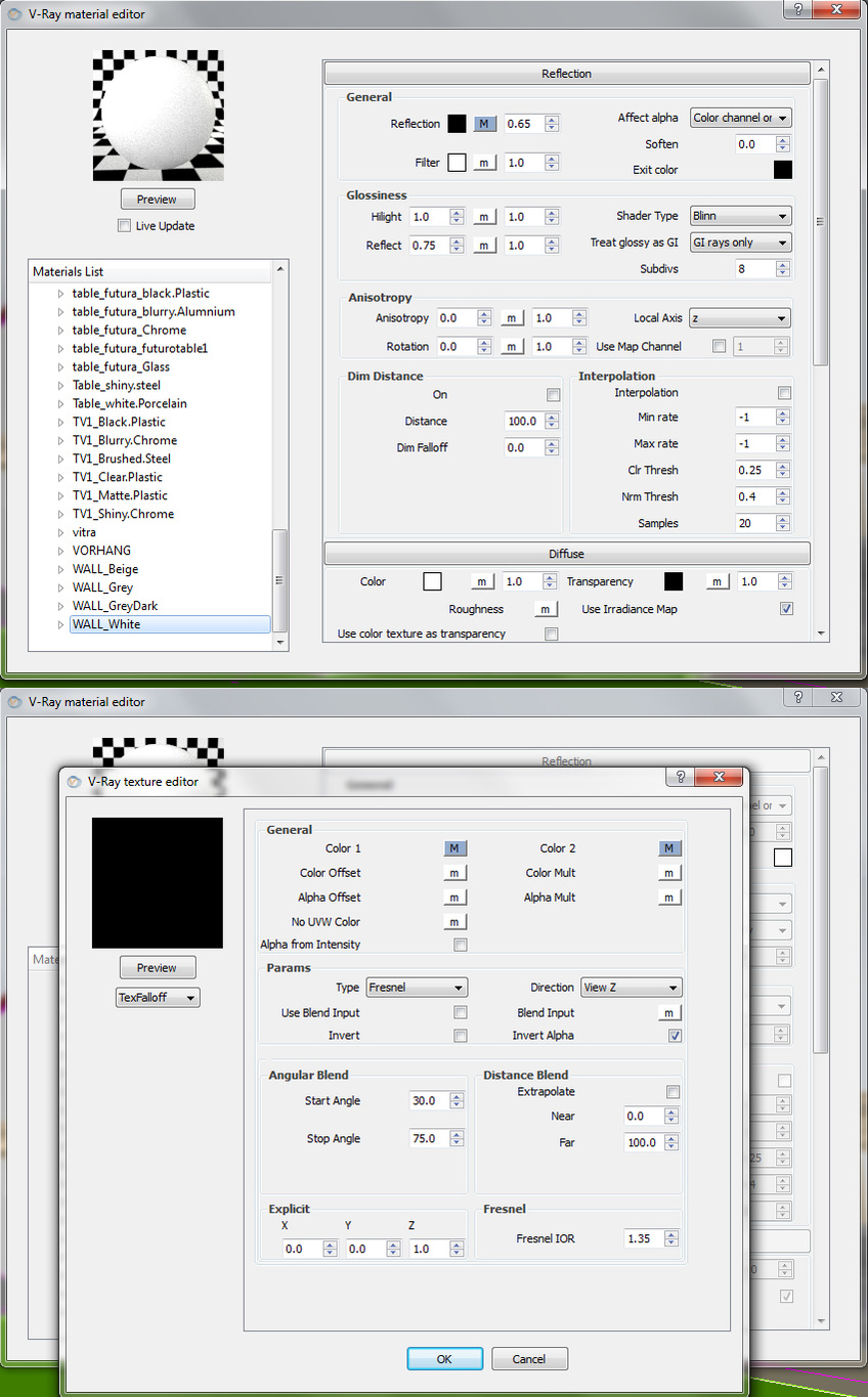

    I recently visualized a small family house [pictures attached]. Although the Rhino File isn't any big - 222.0 MB, and the scene doesn't contain too many polygons, the render time estimated 13 Hours!
    As for I'm not overly experienced with Rhino and VRay, I wanted to ask you folks, if these 13 Hours are normal, or am I doing something wrong (false material or Vray settings in general)?

                @ fooprobe : .I have 17 lights. Their settings and the settings for the "Sun" I use, can be seen in the pictures attached.

                edit: dammit. IM = Irradiance Map.... I attached my Irradiance Settingsa also as a pic.
                @ Rob : .Same as by the two above - I'll test the settings and let you know, what worked best. (sorry, it ain't any kind of competition or something like that...)
                .The light settings can be seen in the pictures attached.

                            I've tested the tipps you gave me for the render settings. Once is for sure - they helped a lot! Thanks, guys!
                            The output size is the same, I used for my 13 Hour session - 1850 x 1307.
                            And the the render options are set after your recommendations.
                            I'll be glad to hear your opinions about the quality to render time ratio...
