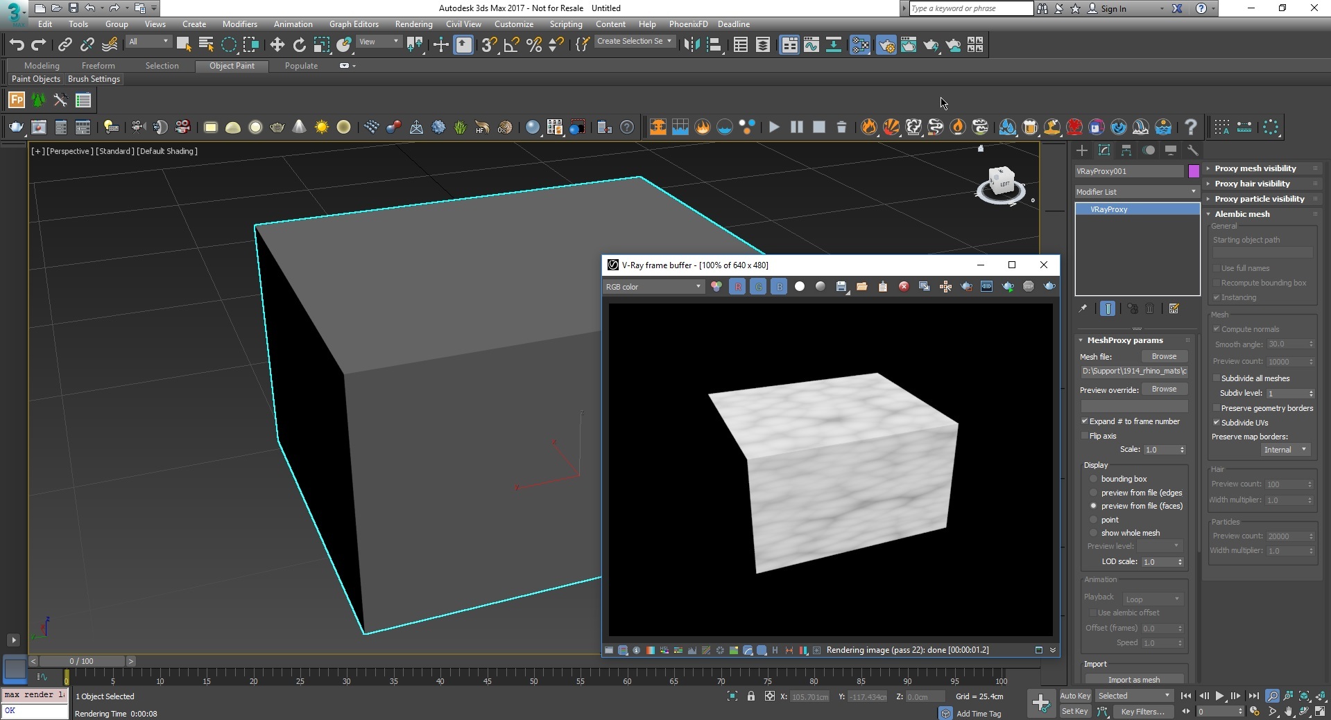

    And here is the same scene in 3dsMax, geometry is exported as a proxy and material as .vrmat file:
    Click image for larger version  Name:	maya_2017-07-06_19-13-14.jpg Views:	1 Size:	283.4 KB ID:	959314
    And the same thing in 3dsMax:
    Click image for larger version  Name:	3dsmax_2017-07-06_19-14-02.jpg Views:	1 Size:	325.3 KB ID:	959315
    Here are all the files if you would like to have a look:
    http://ftp.chaosgroup.com/support/sc...rhino_mats.zip
    Note that the UVs are properly exported and loading into 3dsMax and Maya, this is something that it is expected to work.
