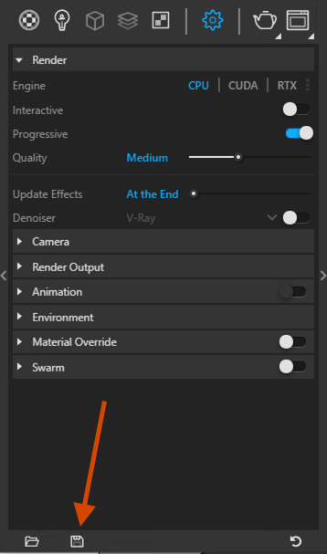

    There is already a somewhat similar option
    You can save settings presets from here.
Name:	Screenshot 2022-01-24 at 16.52.24.png
    Or open an already saved preset from the button next to it Click image for larger version
