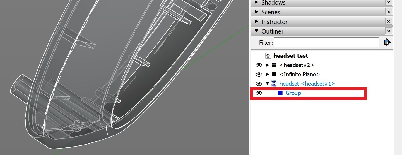

            OK, I found the cause for the discrepancy:
            You have used a 3D Object Space texture placement for the 'plastic-grainy-gray' material bump map.
            Object space means that the size (and the other transformations) of the 3D map are relative to the object transformation the material is applied to.
            And since the sub-group containing the plastic peace is scaled down significantly, the bump texture is also scaled down.
            Once the object gets exported as a Proxy all the object transformations are baked (reset) and the 3D texture is now scaled differently.
            In order to have consistent results you should do one of two things:
            1. Change the texture placement to 3D (World Space)
            or
            2. Remove / bake object scaling.
            To do it just explode the headset subgroup:
            I would personally go with Option 2 to avoid any model modifications.
