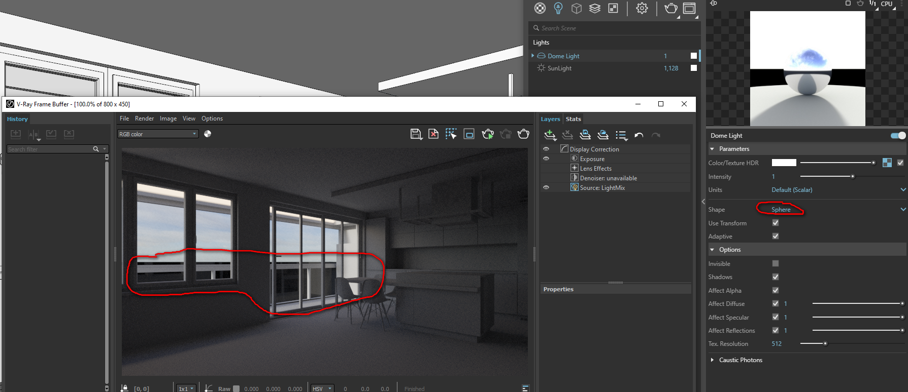

    I use dome light to render the interior. After rendering, a black stripe at the height of the horizon appears in the background. I have the dome light set to sphere. For God's sake, I can't figure out how to remove this strip. Can anyone advise me?

    Setting is spherical but hdr itself is not..
      Hi pavel_hendrych
      As kenancakir mentioned, the HDR image itself used in this situation is hemispherical, which is why this is happening. Make sure to find a suitable (spherical) one and the issue should disappear.
