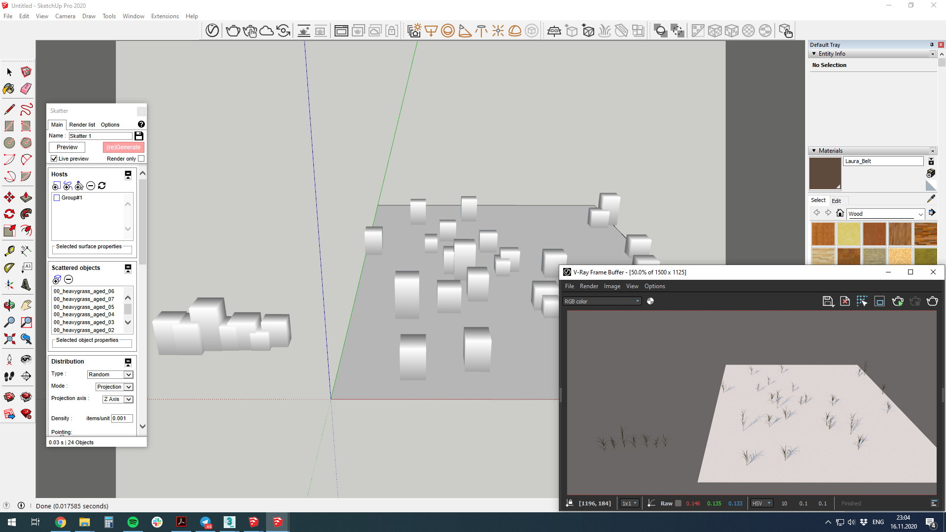

    Hello! I noticed, that skatter's "render only" function doesn't work correct in new V-ray 5, the geometry is not rendering or rendering without materials and looks like preview, how can i fix this?

    See below on the Skatter forum.
    There is a test build skatter_1.4.19a_setup.exe.
    https://forums.lindale.io/t/vray-5-b...bility/2672/22

      Hi VladKapustin
      Please refer to the following forum post regarding the matter.

        It turns out this issue needed fixes in both Skatter and V-Ray.
        You can get the fixed version of Skatter here (v1.4.19 or above): https://getskatter.com/download/
        For it to work properly, you will need to wait for the fixed version of V-Ray. I was told it will be released very soon (maybe today?).
