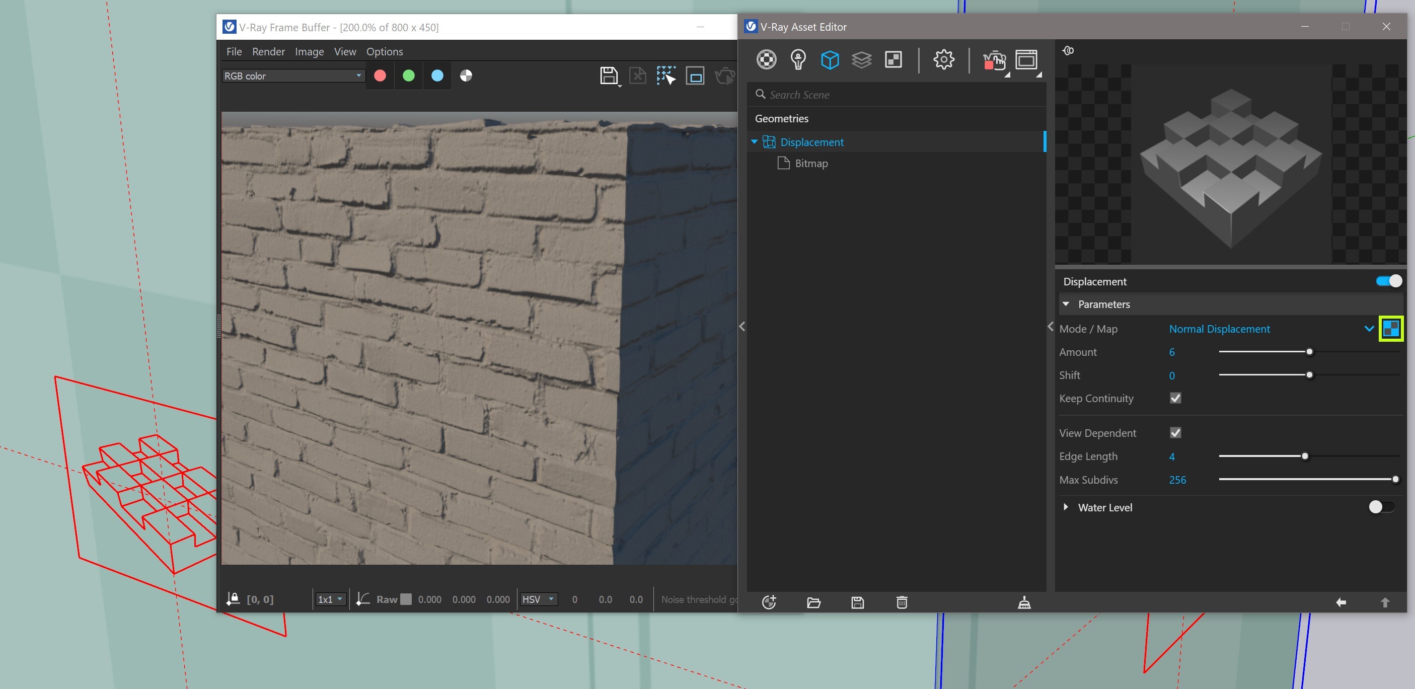

    Hi aiden_humphrey,
    The Displacement modifier needs a separate texture to work.
    The texture placement of the material applied to the object is respected by the displacement but the displacement texture itself is separate.
    Also note that the library material textures are not designed for displacement purposes and might produce suboptimal results.
    In the my example scene I've grabbed one of the scanned displacement texture from textures.com.
    Regards,
    Konstantin
