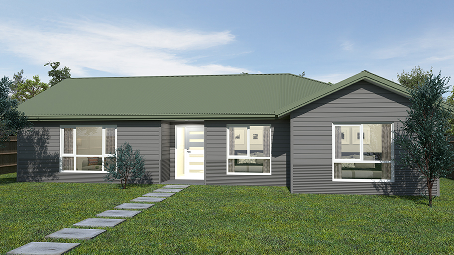

    Hi there, I have just updated from a late version 4 to 5. I have used the same render settings that I always use (that my client requires) this worked perfectly in 4. But now the same camera angle in viewport with the same settings crops the sides of the render. I have attached screenshots of the SU window with and without safe frame (I don't use safe frame normaly. And the rendered output with both sides of the images cropped. If I rill back to version 4 it renders perfectly. Any help would be appreciated,

    The problem that you've demonstrated is V-Ray failing to get the horizontal FOV when the safe frame is off - I'm assuming your render was done this way.
    You can clearly see that the horizontal crop of the rendered image does not match the viewport.
    However the vertical crop does match - 9 tiles are visible on the ground.
