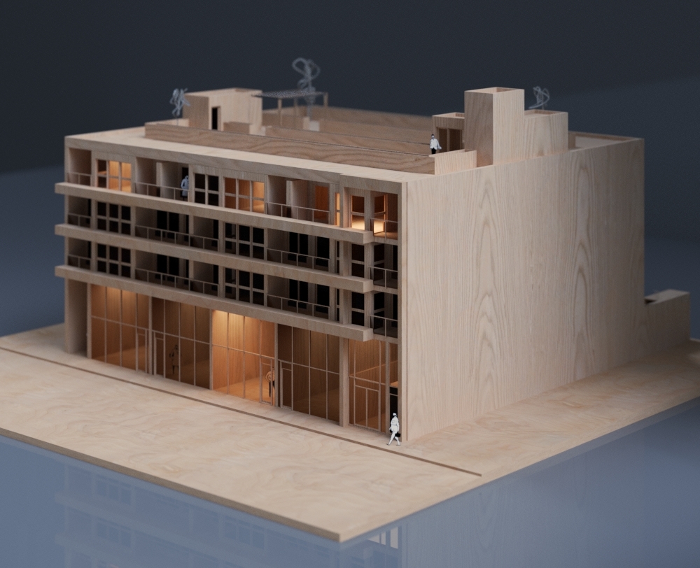

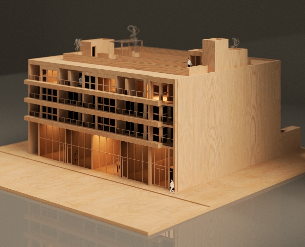

    Okay...So i've been using Vray since Vray 3... I was extremely comfortable with it, I had just updated it to Vray 5 and i've been having non stop issues with lighting and the outside environment lighting (the sun...sky whatever)
    I'm working on a project for work when I use the interactive render mode it shows the lighting perfectly, but when I got to produce the final render it's cold...and blue undertones (..aka cold.) i've never had this issue before I updated, Vray 3 always produced final renders exactly how the interactive mode shows... please help
    i have both images attached, I took a screen shot of both and before anyone asks yes i did let an actual render finish all the way through and it still stayed blue/cool tone

          OP, can you check something for me - I think I’ve figured it out. Is the word “Auto” blue next to your White Balance setting in the Camera rollout? Mine was and I’ve just found that if you set it to manual WB (ie the word Auto should be grey), then production mode has the same tone/white balance as Interactive mode does on auto WB.
          if this works for you, please let me know. Perhaps someone from CG can explain why Auto WB is greyed out on Interactive mode but then gives cold tones on Production mode? Is it that our Interactive mode renders were ignoring the auto WB (if so - where were they getting their WB settings from?) and then when we rendered in production mode, the Auto WB just doesn’t work very well?
          I’m using Brute Force and Light Cache in my Primary and Secondary engines in GI.
            Further to the above, here are some test renders. It's confusing but it seems to me to be caused by using Light Cache as the secondary GI engine AND using auto White Balance. Change either of those and the problem seems to go away.
