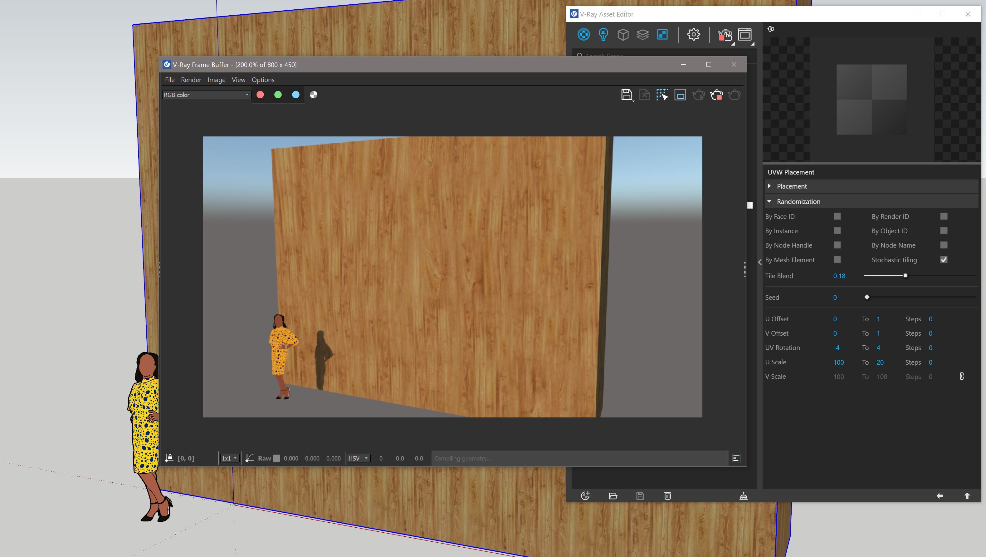

    You can however control the randomization parameters to avoid the texture rotation and use only an offset for example.
    Here's the default Stochastic randomization:
    And here I've minimized the Rotation and slightly tweaked the Scale randomization values:
    Hope that helps,
    Konstantin
