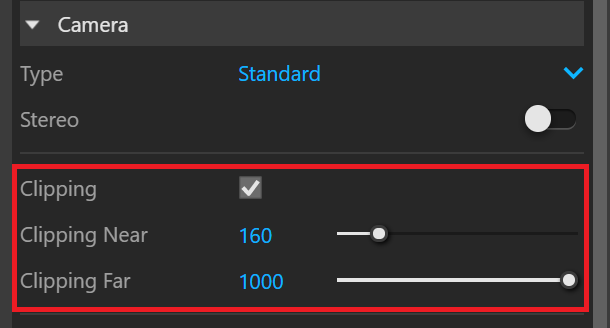

    3. The following parameters will appear in the Camera settings:
Name:	Camera clipping 01.png
    4. You can then change the Clipping Near parameter.
      It'll clip all the objects close to the camera and give more or less the effect you're after.
    This approach only makes sense in situations in which the section plane is used to clip only objects close to the camera.
    Let me know if that works for you.
    Regards,
    Konstantin

      i tried this method and it worked! Thanks for your trick Konstantin!
