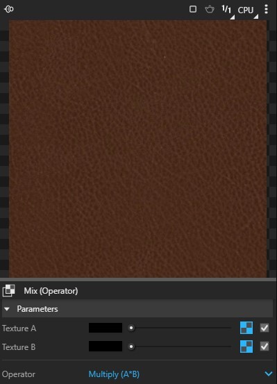

    Material texture is not showing in gpu mode in asset browser of this updated vray 5.2.03 for sketchup. In cpu mode it works fine. There was no problem in the previous version, but the problem occurs in this
    version. What should I do?

    Click image for larger version  Name:	GPU.jpg Views:	0 Size:	13.4 KB ID:	1135030

    Hi,
    Does this happen with all materials(even newly created ones)?
    If it happens with specific ones, could you please send one so I can check it on my side?
      There is a problem with all the ingredients. If you change the preview device to GPU, only black will be output. If you switch to CPU, it works normally. I'm attaching the sketchup file. (Including textures) Vray 5.2.03 Test.zip
        Hello,
        Seems it worked on my side.
        Could you please submit a request here so we can arrange a remote session to further investigate this?
        Please include a link to this thread.

            Hi changhwan_kim,
            Please note that if you start the GPU preview first thing after installing a new version it'll have to compile kernels.
            The kernel compilation stage takes a couple of minutes the first time and will not have to be repeated.
            I'm guessing that you just have to wait and everything will go back to normal.
            To be on the safe side you can run a CUDA render before switching the preview mode.
            This way you'll see the kernel compilation stage progress in the VFB.
