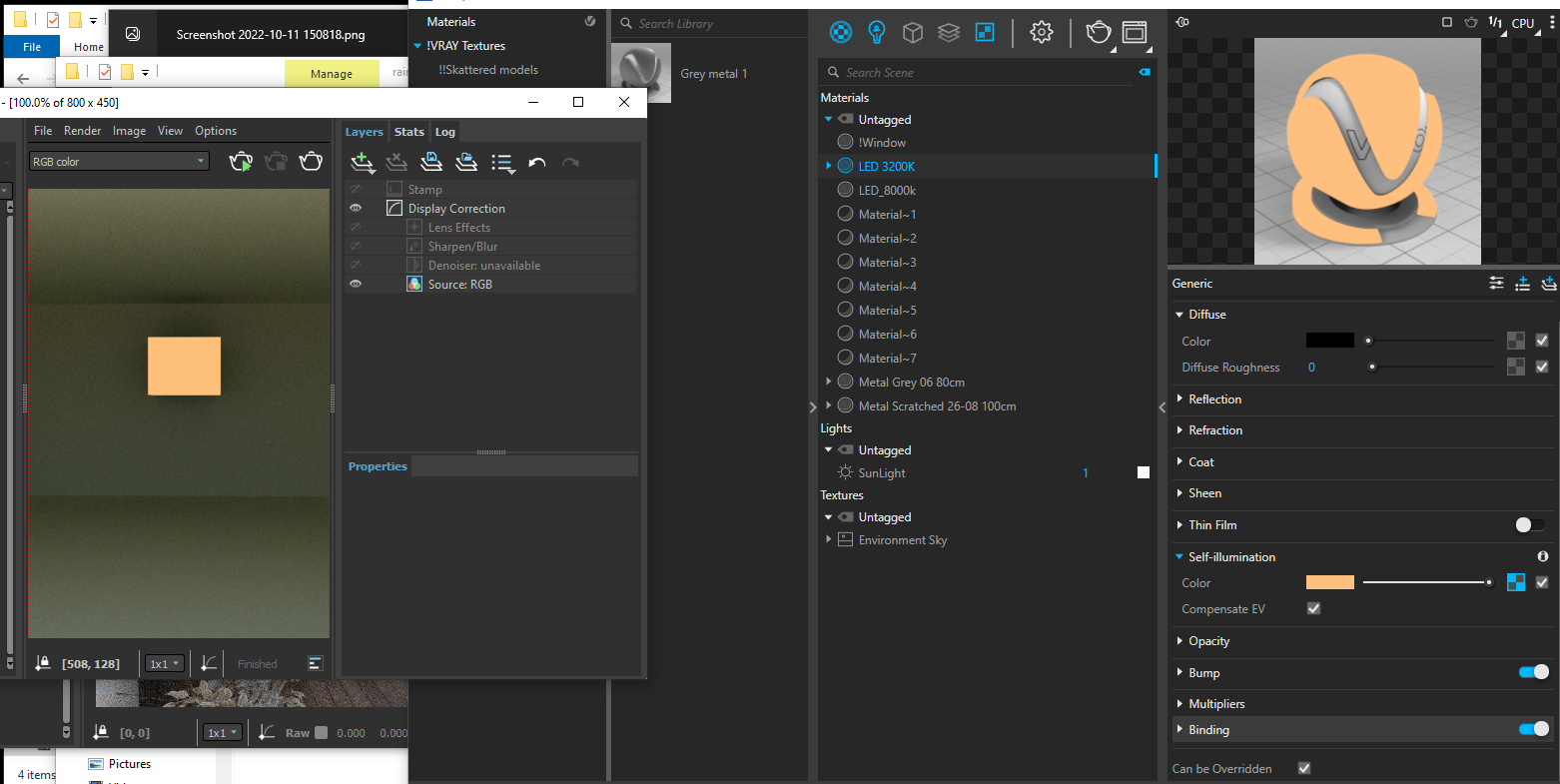

    Hey guys, we upgraded to Vray 6, but when we apply the emissive materials from cosmos, they are not emissive, and there is no intensity slider. I also attached the old version (we had it in an older file).
    Can you check it out?

    The Emissive materials available in Cosmos are Generic materials with a Self-illumination option, which does currently not have an Intensity control in V-Ray for SketchUp.
    Our dev team is aware of this and have already scheduled an assessment of a proposed solution to alleviate the issue.
    As a workaround I would advise you to use an invisible Sphere or Rectangle light for increasing the light emission (in addition to the object with the Emissive material).

      I would like to let you know that Generic material Self-Illumination option with an Intensity control will be exposed in the next update.
      All Cosmos Emissive materials will also have an Intensity control.
