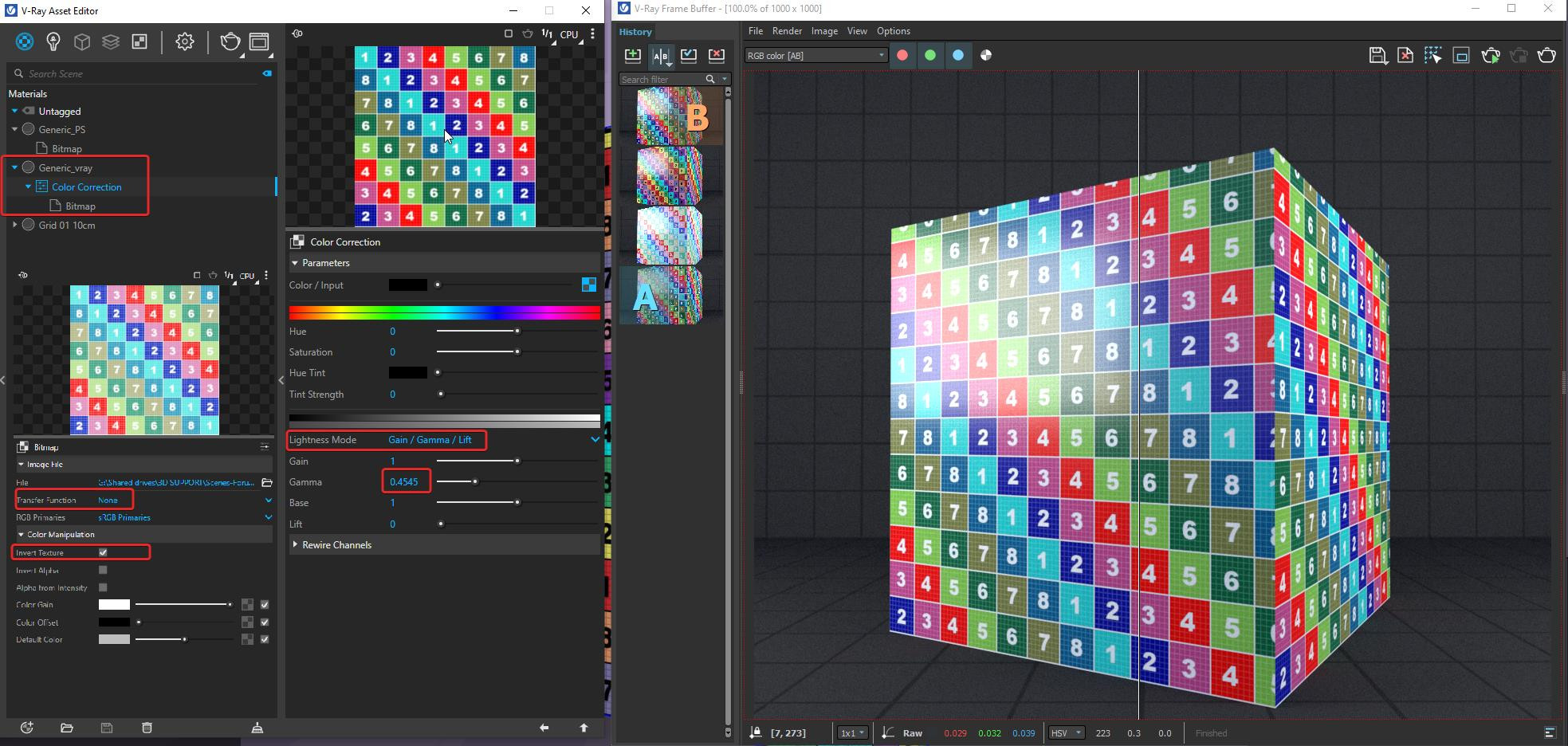

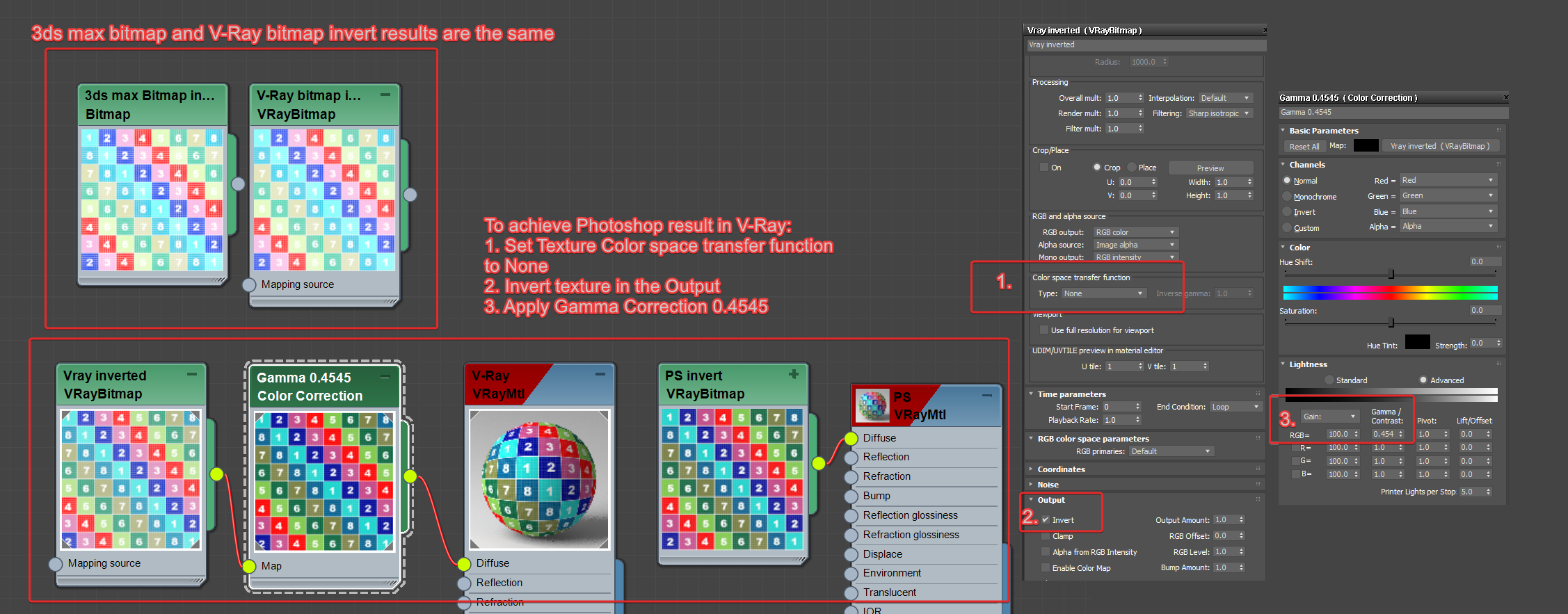

    The difference in Inverted texture result in Photoshop compared to the V-Ray is due to the way different applications work with gamma correction. Photoshop (and other image editing programs) are editing image as it is, while V-Ray (and other 3d renderers like 3ds max renderer used in this test) are importing bitmaps with gamma correction 2.2 if not specified otherwise.
    To achieve the same result as in Photoshop you need to specify Transfer Function > None in Bitmap options. You can read more about what it does in our documentation. And to compensate for Display Correction sRGB space you have to apply Gamma correction 0.4545 to the Inverted texture.
    Click image for larger version  Name:	3dsmax_bitmap.png Views:	0 Size:	691.6 KB ID:	1166163
    Click image for larger version  Name:	sketchup_bitmap.jpg Views:	0 Size:	441.7 KB ID:	1166167

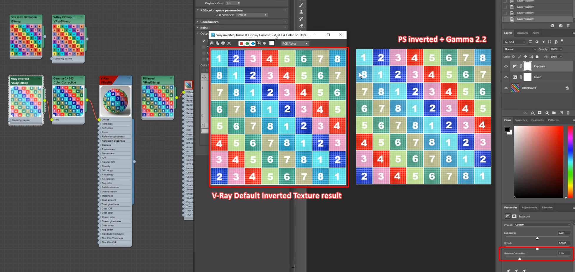

    For example, if to the inverted image in Photoshop we add Gamma Correction 2.2 the result will be the same as default V-Ray Invert texture settings.
    Click image for larger version  Name:	PS+gamma.png Views:	0 Size:	1.42 MB ID:	1166165
