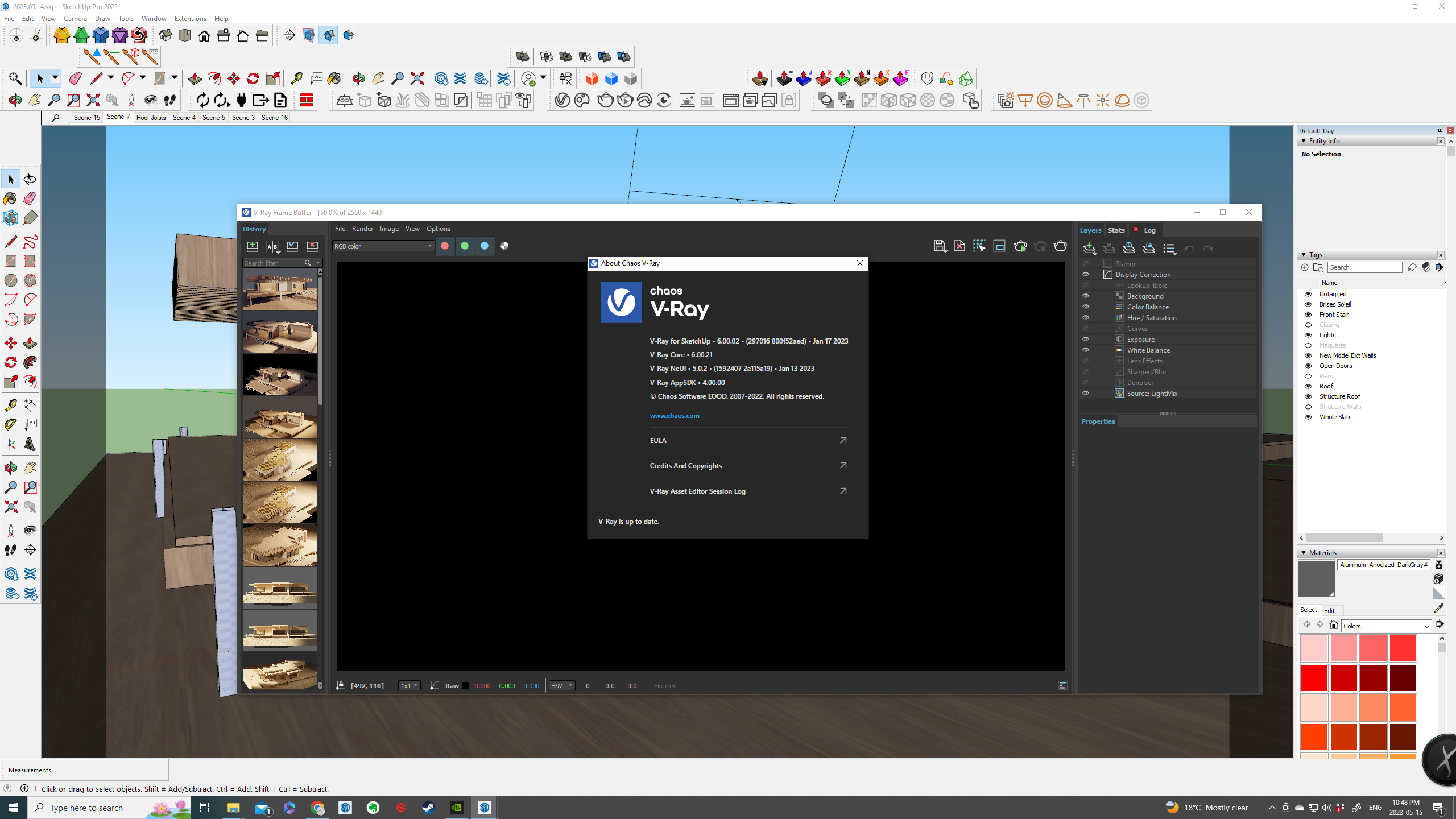

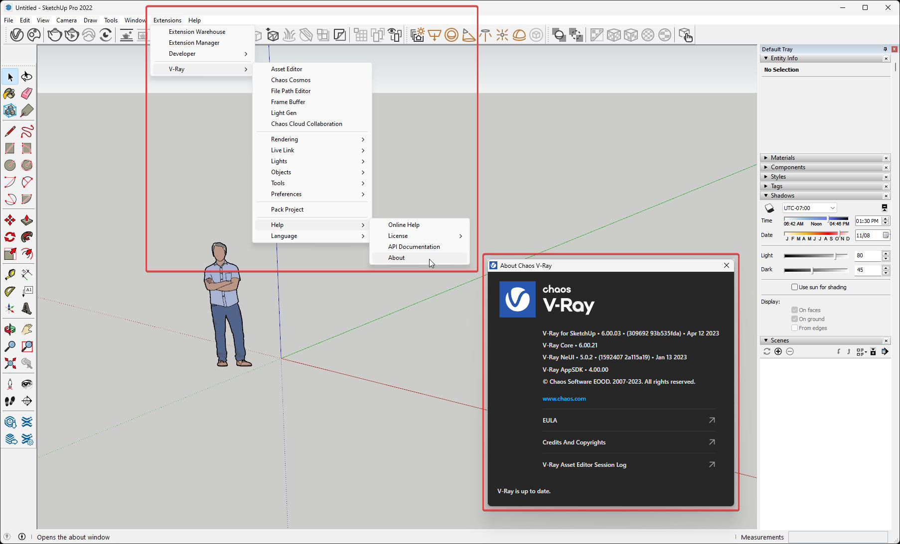

    • A screenshot of About window V-Ray for SketchUp to confirm the exact build you are using.
    • What is the current GPU driver installed? Please note that the latest recommended version is 531.41, if you have different drivers installed - please install 531.41 version.

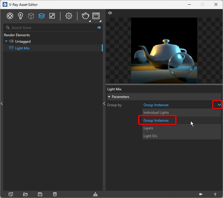

    I can see from your screenshot that you have LightMix added and I wanted to point out that LightMix as well as other render elements requires memory. In the case of LightMix if you have it set to Group by Individual lights try changing it to Group Instances. Additionally you are welcome to check this article for more information about GPU optimizations that may be of help.

      GPU driver is 531.41
      Build Details attached.
